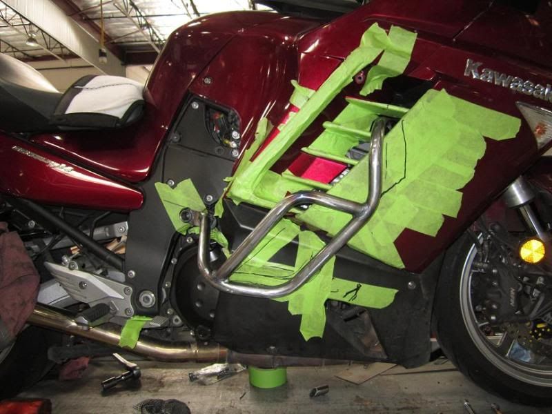

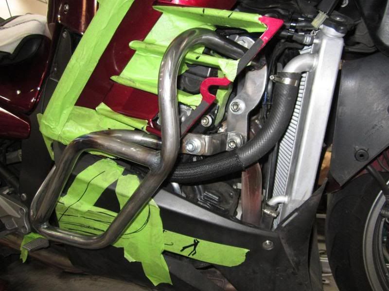

That 'hidden' mount point is really slick!  I was a bit worried about the mount points being a bit too co-linear for good deflection strength on the lowest part of the rectangle, but seeing the 'behind the curtain' shot with the fairing out of the way makes me feel a lot better about it.  It also looks like there should be a couple of good options for places to mount highway pegs.  Strong work gentlemen!

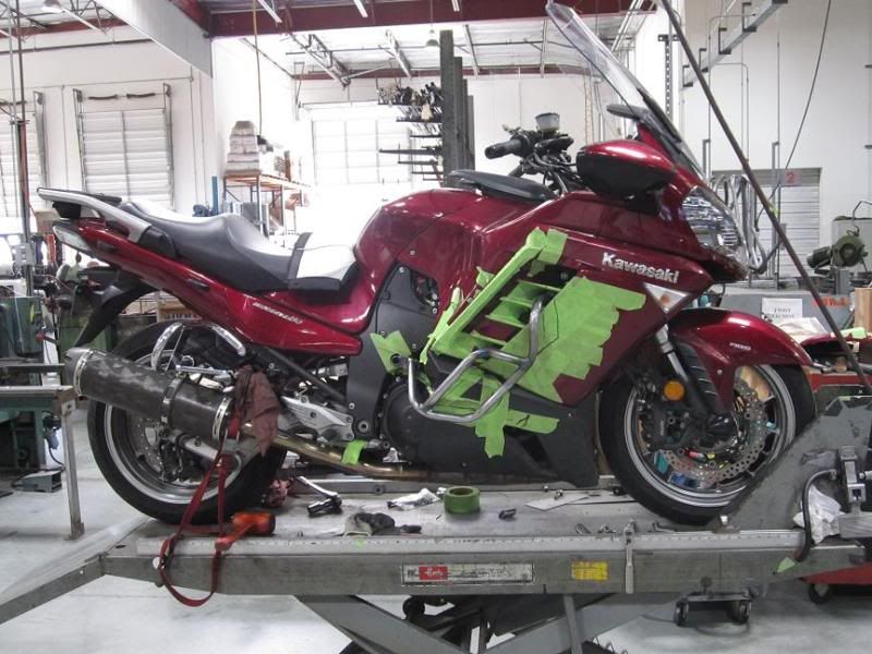

Is there a reason the bottom horizontal bar needs to be so low? Raising it to follow the lines would make it look better and stronger it would seem. Looks better and I like the three mounts. Glad you're back with the living.
JP
Does appear it could raise up a bit, if you use the bottom of the Gen 2 cage as a reference. Unless there's something throwing the photo off.

Thank you guys for your kind words! Regarding some of the points that you guys brought up: There is definitely room to mount highway pegs, it's just a matter of where on the bar you want them. The only concern is that we went with 7/8" tubing on this set to match the rear guards we've been making for this bike for years so you'll need to find 7/8" clamps (I believe RivCo sells them). Regarding the placement of the lower horizontal bar, it does need to be that low on the bike in order to protect it properly. I think the bar would look better if we could raise that lower bar a bit but unfortunately we've raised it as far as we can. If we were to raise that lower horizontal bar even 1/4" more, the lower subfairing would actually hit the ground before the bar would during a tip over which isn't acceptable.

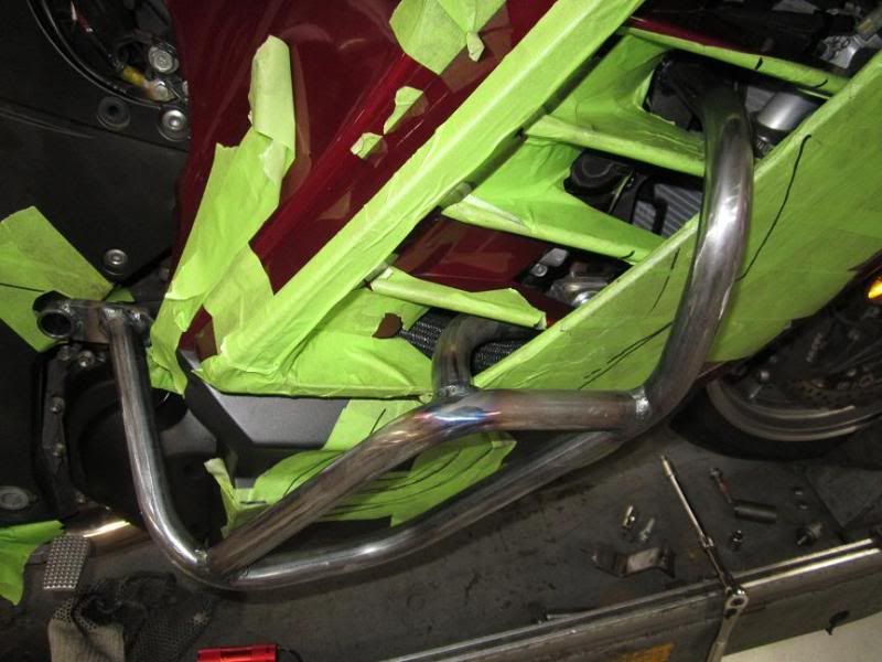

I am impressed, Ryan!  I didn't even know there was a mounting plate behind the fairing... that changes my thinking a lot (is there one on the gen2 bars also?).  I do like the design, And the more angular parallelogram works better with the gen 1 fairing.  However I would like to have seen the front vertical bar go up the bike much further before turning to go into the top vent.  There is even already writing on your green tape showing what I mean.  You didn't address that concern in the previous postings.  There might be some perfectly valid reason you can't do it/try it, but I would love to know what it is :)

Alrighty, I got some updated photos for you guys. A lot of you were saying the rectangle portion looked a bit big so we minimized it as much as possible. I've previously stated that we're a bit limited on how we can shape the rectangle due to the available mounting points but we did what we could with what we got! Let me know if you guys think this design is a step in the right direction or if you have any other comments or opinions, please share!
Taken from a step or two back:
Closer:
View from above showing the "hidden" mounting point:
Here's a cool shot I took with part of the fairing removed so you guys could actually see the mounting/bracket work:

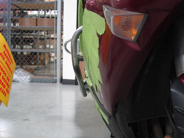

The third mounting point makes the rectangle make sense.  Can we see a pic from direct front and rear to see how far they stick out?  Are they tucked in as far as is safe?
Of course, I have a gen2 Concours 1400, but I am looking out for all my gen1 friends on this forum, who need bars that look just as good!
You're the man, maxtog! We seriously appreciate all of your input throughout both builds, you've been a tremendous help! Anyhow, the reason we didn't extend the front vertical bar further up the bike before turning it in the higher vent is strength. Extending the bar in that fashion would put it farther away from the mounting points which, as you know, would make it weaker. Also, I think extending the bar in this fashion would make it look a tad goofy because the rectangle portion has to be so low on the bike. I think it'd be funky to have the rectangle that low with a single bar extending that high up.
They're definitely tucked as far in as is safe, just like the Canyon Cage for the 2010-2012 Connie. We wanted these guards to be as close to the body of the bike as possible to allow for extreme lean angles and to eliminate worry when lining through traffic. Below are a few photos to show you just how close they are!

They tuck in very nice. It appears the mirrors are still the widest point on the bike.
