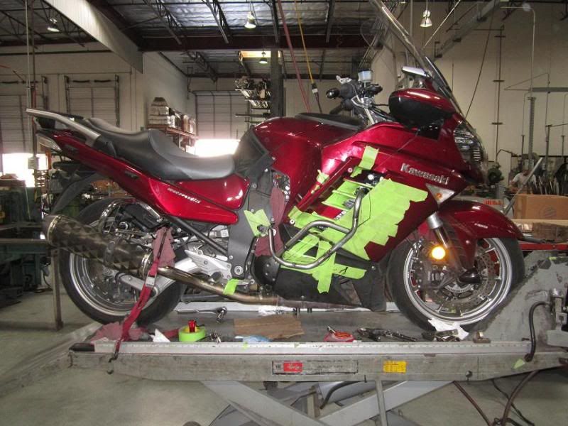

Here is a variation.  Lower part of cage is the hardest part trying to get the cage low enough to hit first with not much room to bend radii.  Other wise the cage follows similar front line as MCE crash bars, everything else relates to the lines of the fairing and flows well.

I was thinking that bars parallel to the lines would be better on the eyes.  This is rough but just my thought:
Exactly what I would like to see. Just extend the bottom bar to account for the initial contact point if the bike is dropped.

Here is my design.

I like that one!

Nice, but shouldn't the vertical bars be wider apart to spread the load?

I wouldn't mind having to drill a hole in the plastic if the aesthetics are right. Function first, but would like it to follow the body lines a bit more than the mock shows.

My advice would be to rotate the rectangle section forward and make it (the top line of the rectangle) run parallel with the line that separates the lower and middle fairing.  JMHO
The parallel lines of the rectangle should match the lines created by the air fins...

Is there any way to get the front vertical bar to go further  forward? Possibly curling the top bar forward as it exits the fairing or... use the top mount only to exit the fairing, then let the top bar go past that point and bend down 4 or 5 inches forward with the top mount welded to top bar from behind. I agree the horizontal bars need to follow the lines of the lower fairing. Good luck...looks like a real head scratcher.

I'm liking all these comments! Definitely some good ideas being tossed around. Since there were so many of you to comment, It'd take me a long time to answer everyone individually so I'll just address some of the main concerns that have been brought up. Firstly, I definitely think the horizontal bars need to be tweaked to flow a bit better with the fairings. As it is currently there is no drilling necessary but we're a bit limited by the mounting points we have available. If we were to drill for one of the mounting points that would open us up to quite a few more design options. With that said, we're not sure where the hole would be yet, that would really depend on what design we came up with. I think it'd be easier to create a design that's easier on the eyes if we were to drill because then we can pretty much make the bar however we want without having to work around the vents and the externally available mounting points. Also, if we were to drill, I'd prefer it to be into the black subfairing part but most of the strong mounting points are slightly higher on the bike behind the colored portion so we have to keep that in mind. Furthermore, when recommending a certain design, keep in mind that the bar must cover the portion of the bike where the lower rearmost portion of the "rectangle" is currently because that's where the bike first comes in contact with the ground in a tip over.
I'm going to go talk with Armando and see if we can apply some of these changes. I'll post more pics when we have something mocked up for you guys! Thanks again for all of the recommendations and support! You guys are part of the reason we ended up with such a great design for the 2010-2012 Connie and hopefully we can get something similar made up for this bike.

When you post the next pictures  can you also post one of the 2012 model to compare it too. The close up picture makes it hard to visualize the overall design. The 2012 bars are right on in my opinion. This would let us flip from one to the other. Thanks

Sure, I can definitely do that! Unfortunately I think we'll have to go with a different design than we used for the 2010-2012 because of the vast differences in fairing angles and accessible mounting points but I can definitely post both photos so you guys can compare them side to side.

Hey guys! We tweaked some of the lines to make them flow with the lines of the bike a bit better. Check out the latest design and let me know what you think! Keep in mind, the lower horizontal part of the rectangle doesn't look perfectly parallel to the top horizontal bar of the rectangle because the top is a straight bar and the bottom bar is bent to curve around the fairings. It looks a tad awkward in the photo but looks better in person.
And here's the 2010-2012 Canyon Cage as requested for side by side comparison:
