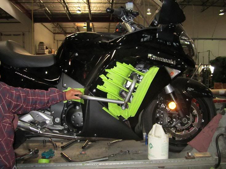

This is almost exactly what i was describing. Color match these bars and they would blend in so much better then the straight bars. It would be only slightly weaker then the straight bar, but nothing that would be noticeably different in a drop application as long as a reasonable wall thickness is used.

I would lower the bottom bar more like this and maybe alter the angle of the vertical bar just a bit. The vertical bar wouldn't need the bend altered just a slit rotation and notch to line up the bottom. My paint shop skills are a bit limited.
Re: MC Enterprises Concours Canyon Cage Discussion
« Reply #304 on: April 09, 2012, 07:21:50 PM »
Well, they already lowered the lower bar so it would meet at one point.  GordonM just grabbed the pre-fixed version for his photo editing (impressive photo editing at that).  The angle of the vertical bar was actually OK as it was sitting, I think your suggestion for tilting it a bit more is even better, but they do have to work with where the mount points are located.
I didn't realize just how much more I like the GordonM version until after I went back and looked at the other design a while, then looked back at the new slanted version.  The more I look at the slanted ones, the better it looks.  I hope it is not too late for this to be seriously considered...

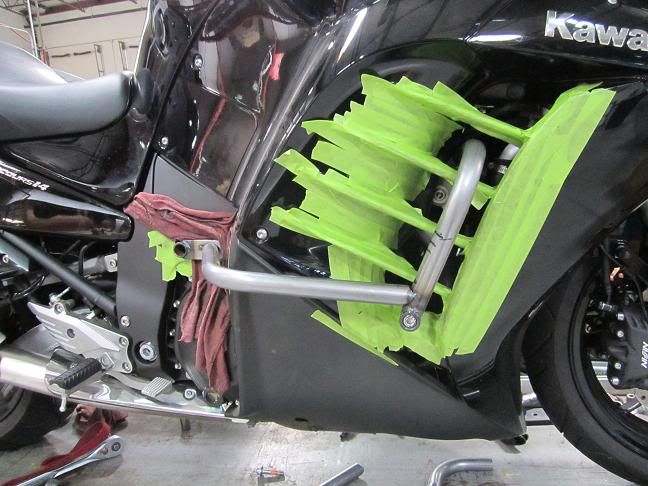

My knees and shins are pretty darn close to that surface of the fairing, I worry about this newer design and leg room.
A valid concern, but it looks like the rear bending up part is still outside the fairing and the parts coming off the rear mount are not much higher.  Of course, it is just a photo mockup.  My guess is that it could be made with the identical clearances.

Wow, it seems as though Gordons design is the most popular. It's definitely not too late to try a design like that out. I have two small concerns, though. One is strength and the other is where the bike is going to hit. Gordon appeared to move the lower bar up a bit which could be dangerous. This bike tends to hit fairly low and far back on the fairing, that's why we originally made the design with that lower horizontal bar closer to the ground.
I'll show this to Armando, though, and see if we can get one mocked up for you guys. Gordons design will require us to make an entirely new bar but that's okay. We should be able to crank it out by this afternoon. The owner of the bike is allowing us to keep it another week so we can continue to play around with designs as to exhaust as many options as possible. I'll keep you guys posted...

I like the prior design.  Even though it didn't flow with the fairings, it seems less conspicuous because it's lower on the bike.
I personally preferred the prior design as well but a few people expressed interest in Gordons version so I think we'll work a set up like his just to see what it looks like on the bike. It can never hurt to try! Honestly, this bar is so minimal that when it's finished it'll disappear into the fairings anyhow. If, once we have Gordons design worked up, we decide we don't like it we can always revert back to the prior design.

I hope that I am not creating controversy with this project.  I am mainly trying to throw out some possibilities to improve the appearance.  I am not the expert on the protection and fall down characteristics other than knowing where the Connie hit the ground with the current MC Enterprises crash bars.  I had my doubts over moving the contact point up when the bars where rotated to align with the vane angle.  The lower front attachment point creates alot of the problems.
Here is another approach which lowers the contact back down again although it is not a horizontal bar to contact the ground and it complicates the lower front attachment point and I am not sure about all of the welding involved and the strength of this joint.  But it does smooth out the look where the bars interesect the attachment boss.  Photoshop allows you to try alot of ideas before building the parts.
I probably could have lived with the bar design when it had the single horizontal bar intersecting the angled front mount bar, but when the second horizontal bar was added it  was just too many horizontal lines conflicting with the angled vanes of the fairing.
