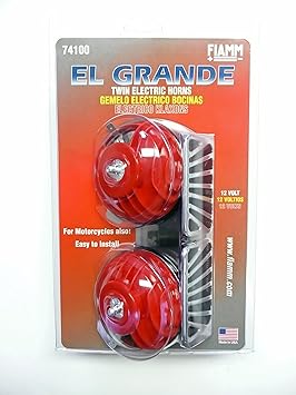

+1  But used the FIAMM 74100 El Grande Twin Horns (Note: Requires a relay.)
Mounted in the same location but used two "Universal Brackets" (included with the horns) to connect to the stock mount.
Angled them at about 45 degrees laterally to clear the the top of the front fender.
Used a stainless steel bolt, nut & lock washer to connect the brackets to the OEM mount.
Been on there for 3 years without a problem.
Loud as hell...sounds like s sports car horn.
