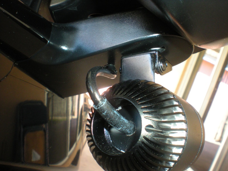

Real Time LED lights installed on Big Buck mounts. Have to get some night pics of brightness.

[pics]
Hmm.  Well, it does look like they have nice, well defined, round beams.  But you also have the beams WAY above the low beams line, which is a huge "no-no" if they are on with the low-beams!  (And here it would be illegal and also fail state inspection... and for good reasons, it will blind oncoming traffic).
My suggestion would be to either keep the beams like you have them, but make sure they are wired into the high-beam only circuit, or dramatically lower them, and also spread them apart a bit.

Too wiped out to mess with them tonight I am going to lower them and spread them out a bit. You must live out West or up East in Nazi land. Here in South MS where only one tail light is all that is required it wont be an issue LOL. Frankly I don't ride much at night and these have an off switch. I am amazed at how bright they are for LEDs
