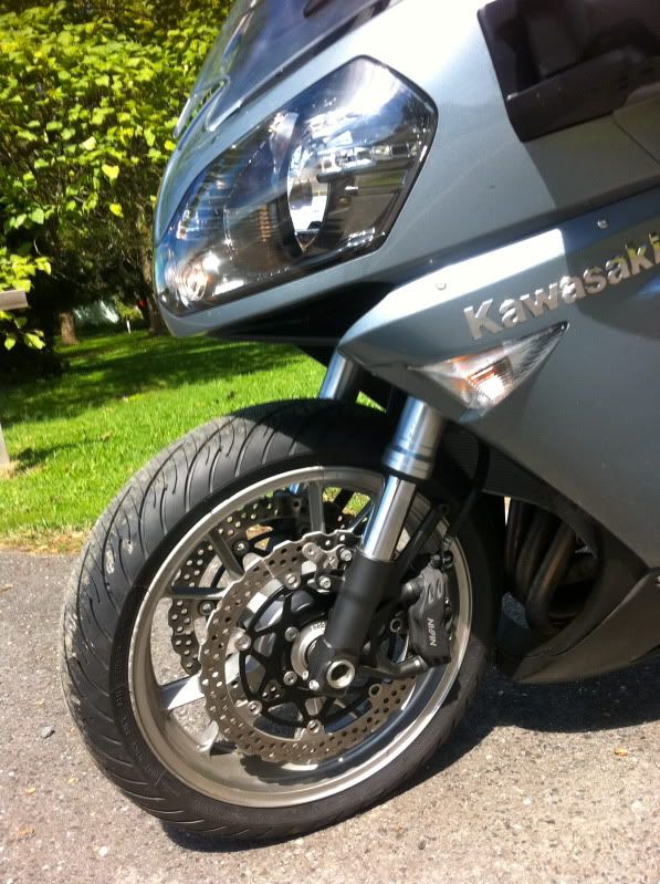

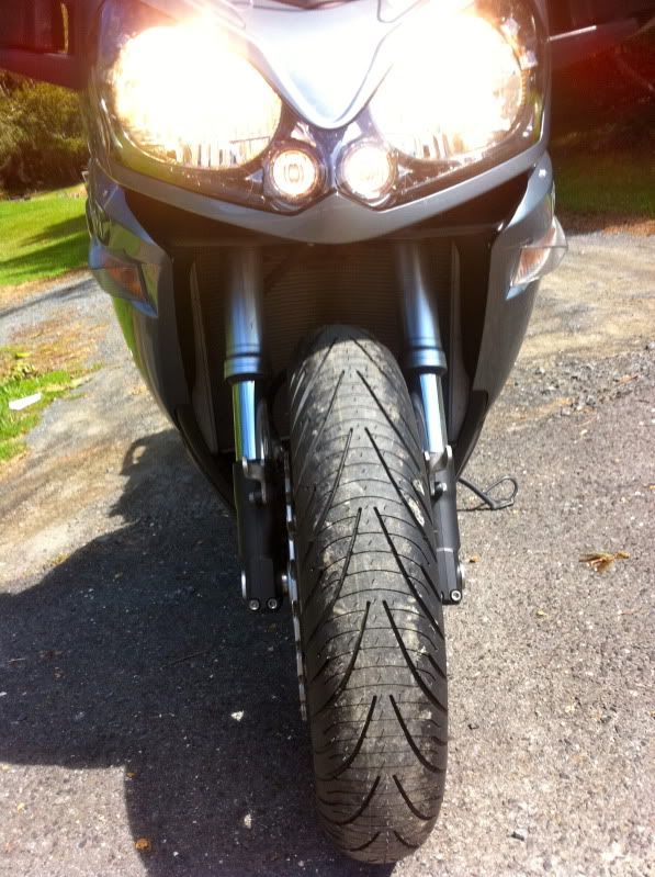

Had a hell'of time, installing my PR3's
« on: September 09, 2011, 01:13:29 PM »
I don't have a lot of tire installing experience, especially in the last 20 yrs. :)
I was ready enough for a new set of sneek's because of a road trip I have planned, so I wanted spanking new PR3's on my Connie for the start.
The back tire wasn't any problem, except getting seated. After about 1/2hr. it magically seated and took her for a quick test spin. Thank goodness I knew enough to crawl till I was sure things were good to go, because when I stepped on the rear brake, it wasn't there. I had forgotten to replace the anchor bolt for the caliper and it swivel, pulling the brake line into the cotter key.

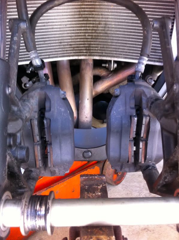

Got a nice stainless off Amazon, for less than Kawa's replacement rubber line.
After repairing that, I felt mentally ready to attack the front wheel for the PR3 install. It was a little harder than the rear for me and I couldn't get the front seated for all the gold in Fort Knox. Took it to the dealer this morning and let them blow it up and balance it.
Remounted it and took a six mile test ride. It was worth ever dime and the loss of sleep last night from the aggravation with the front wheel.
Gotta finish up in a little while(front fender). Anyone else mount their Connie's tire, did ya have any issues?
