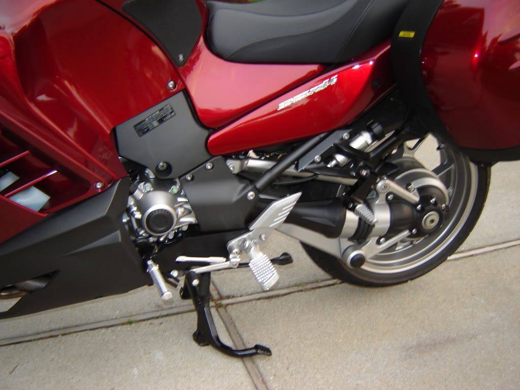

Check it out!  I ordered a set of Ronnie's Highway Pegs but asked him to powdercoat them in a silver so as to have them blend in and look like they came with the bike.
Review:  After about 500 miles, half highway, half in-town, I have come to the realization that they are worth every penny but no modification comes without some form of compromise.  On the left side it pushes the footpeg out 3/8" which isn't a problem but on the right side it pushes the peg out 7/8".  This puts my heel against the guard and puts it to sleep which didn't happen prior to installation.  That's it.  Everything else is great.  The installation instructions are professionally done and very easy to follow with color pictures for each step.  Can't ask for more than that.

Here's a couple more pics

Sorry it took so long to respond but i've been away.  I just got back from a 1,500 mile trip to the tail of the dragon from South Easter Michigan.  90% of the miles were on the slab.  Without these pegs, it just wouldn't have happened.  Its great for changing positions and getting some feeling back in the feet.  I have size 13 Icon Tarmac Ventilated (black not the white moon boot version).  I have had absolutely no interference as far as bumping them or hitting the other controls.  Along the journey, I found that not only can you put your feet on them but you can put your feet over them and rest them on the calfs.  This may be a problem on the '08-09's due to heat but absolutely no problems on the '10-11's.  My boots are ventilated so if there were heat problems, i would have found them right away.  I have about 6,000 miles with the pegs and couldn't get around without them.  I only use them on the slab or I would probably try and hit the invisible brake and shifter.
Install requires minimal to moderate handyman knowledge.  Anyone can do this with the instructions provided.  Just make sure you have some WD-40 handy.  These are aluminum and even with extensive usage, I've had no wearing of the powercoating.
