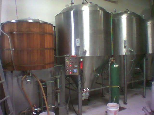

I told you to bring that cash farm you got over to my garage, I'll take care of spending it for you. Imagine the brew set-up we could have.
 ;D :chugbeer:
