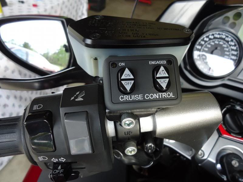

I mounted the control switch on the left.
I used Murph's aluminum bracket which is designed for the right side. I filed off the screw boss on the backside so I could attach it to my homemade bracket on the left. I've seen it mounted low on the left as well but I think my tank bag would have a problem with that. Mounted on top is more exposed to rain but easier to cover with a baggie and a rubber band. Murph's  switch covers are ugly but  cheap (3 for $10.25), even if you don't want it on your bike all the time I advise you keep one handy in the glovebox. My baggie was never there when I needed it. I think my glovebox was eating  them.  ;)
Re: Any Rosta's mounted on the left side?
« Reply #5 on: April 11, 2013, 11:33:05 AM »
I first mounted it low. It was harder to operate with gloves on since with heavy gloves you cannot feel it and have to look. Up left like this turned out to be the best for me.

« Reply #6 on: April 11, 2013, 01:36:56 PM »
Mine, pretty much like the others less the orange buttons.
