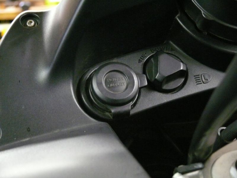

Has anyone converted the stock C14 power outlet to a Powerlet?  I installed a 2nd stock outlet hoping to cure the problem of a loose connection.  No success.  Tired of stuffing toothpicks and still losing power to my GPS.  Just want to know if it is a direct replacement or if modification required.  Thanks,  Jim

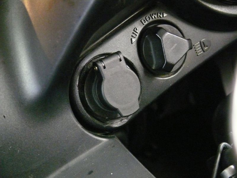

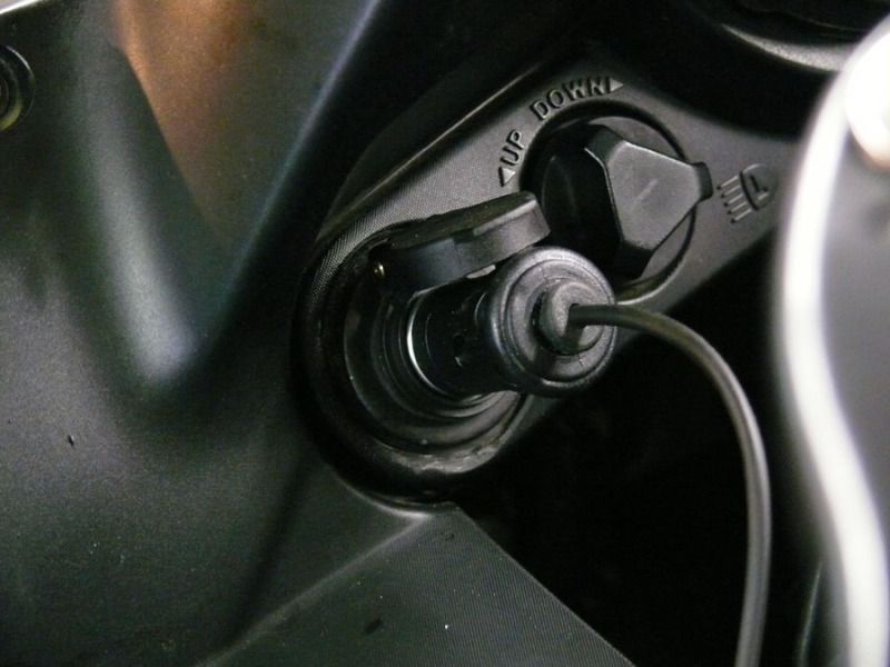

The PowerLet sockets fit fine in the space behind the left hand panel.  They are a little smaller in diameter and length and the installation would have been easier if I had not already installed a stock outlet.  Because the hole cut for the stock outlet was larger than the PowerLet  I had to use a fender washer  on either side of the plastic panel, but it turned out fine.
