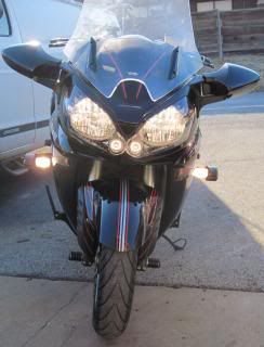

Here's what I came up with.
Lights are 55w, comes with wiring kit and lighted switch... $20 Walmart.
Mounted on TRex crash bars.
Here's how well they work at night:
Huge difference!
