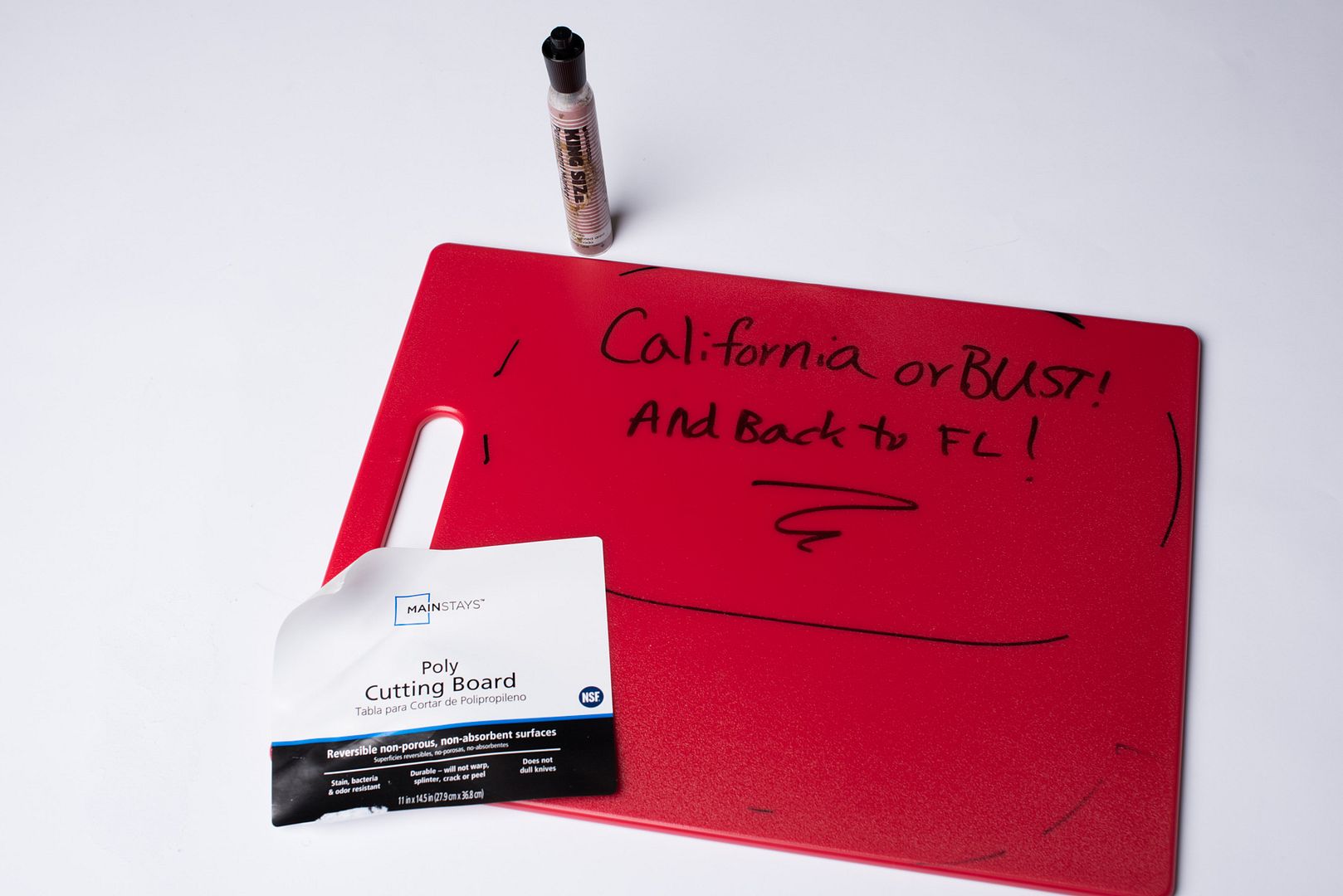

Refused to pay $40-50 for the "plate" to mount my rotopax spare fuel tank onto the wolfman ADV luggage rack. This project went "KLR on the cheap"  style
Instead I got $16 worth of parts/nuts/bolts and fab'd my own.
I usually shop Target, but Teressa finds this cutting board at the Wal-mart store
So under the knife it goes.....  and the cut off pieces fall right into the recycle bin. Not that I'm all green like that....

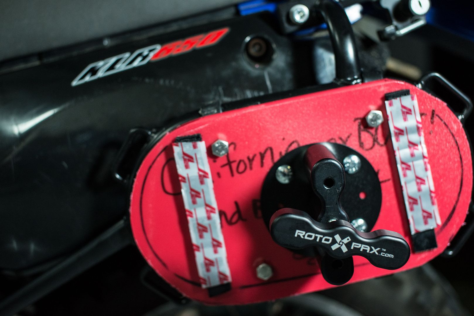

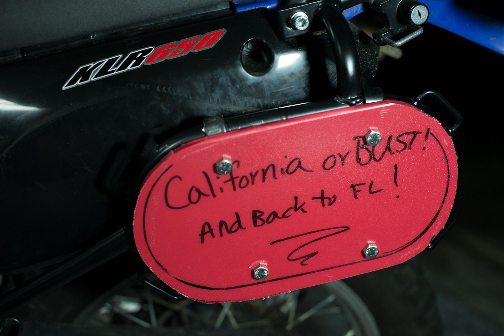

Couple of dollars worth of Ace Hardware bolts and these weird rubberized straps that allowed us to bolt a flat object to a tube and we're there.

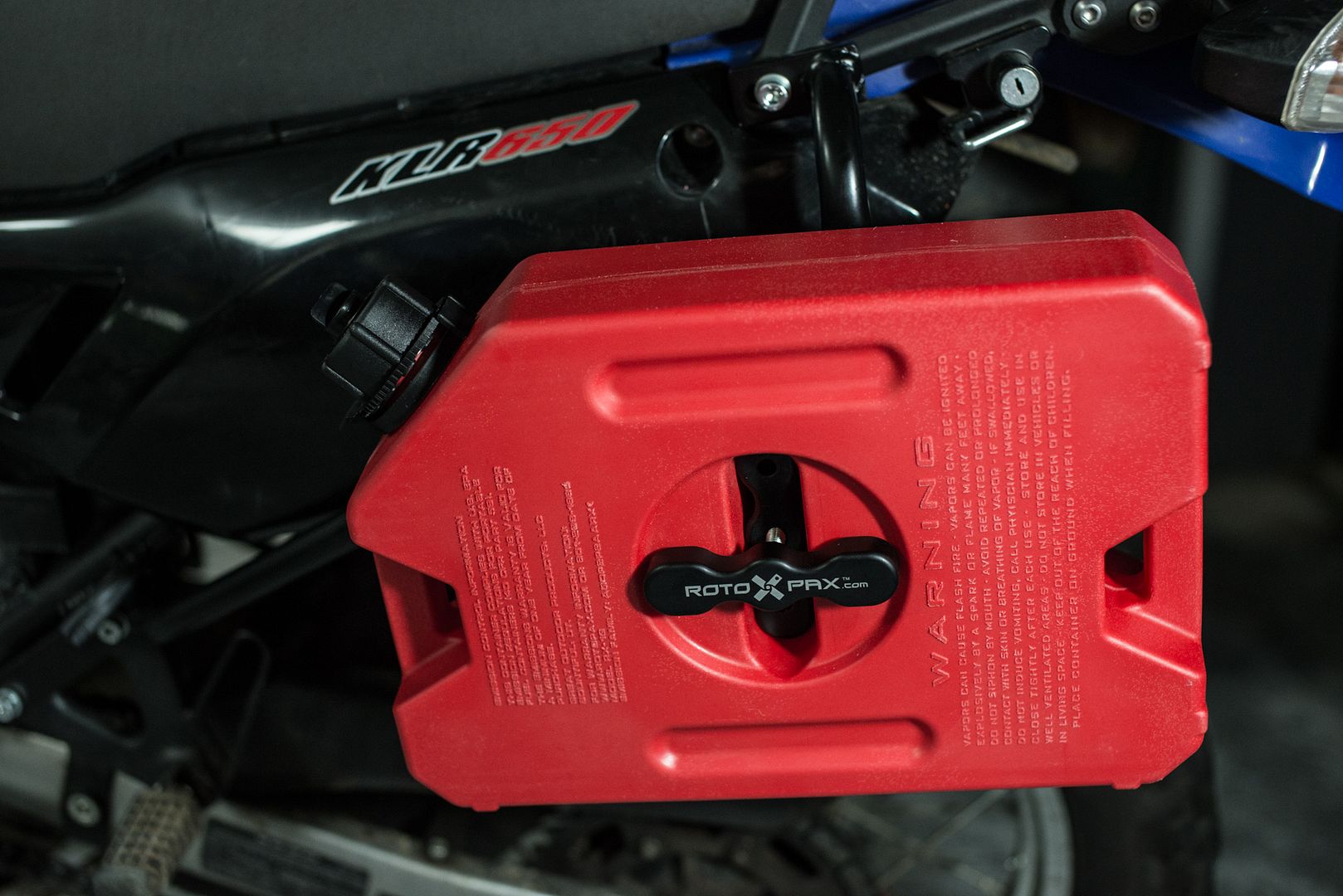

Added the part of the rotopax tank that gets mounted to a plate.  Then I added some padding strips for no other reason than piece of mind.  Plus i like it because the rotopax/wolfman plate didn't have such
Now I'm ready to throw over  the wolfman soft panniers on and roll.  With 50-60 miles, 1 gallon more gasoline for the desert (in addition to the KLR's already 6.1)
