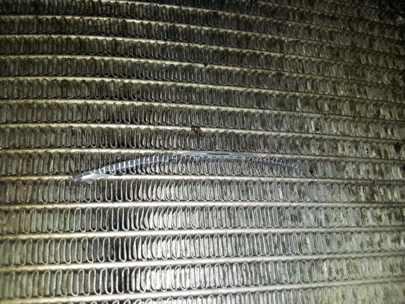

Looks like my radiator is on its last legs as it has a few leaks. I'm going to get the core replaced which is cheaper than buying a complete unit. When I took it off this morning, I noticed the following incision at the rear of the radiator (and I assume this is where one of the leaks is from). The only item that could leave such a mark is the cooling fan. I've had a look at the cooling fan and it seems fine when rotated. Should I change them as a precaution as well?

 :o
Are you running the stock plastic fan or did you change it out and go with one of the metal ones?
Re: Radiator leak
« Reply #2 on: March 17, 2012, 11:22:23 AM »
It certainly looks like an arced fan blade mark to me.  But I don't understand how that could happen, unless something were bent/moved and reduced the clearances.
I would be greatly concerned before just slapping a replacement radiator on there.  But just replacing the fan wouldn't not necessarily correct the root problem.   Looks like you will have a lot of measuring to do :(

« Reply #3 on: March 17, 2012, 11:27:31 AM »
Look for a cracked blade.   We have this happen at work on a regular basis.  Its hard to diagnose, though, as few are willing to stick their hand anywhere near a fan at full speed..go figure.  The shape and angle of the fan blades change when its at full speed. A cracked blade may flex enough to hit the rad.  Or, the shop turned the engine on before the fan/radiator assembly was properly mounted.

That looks like a fan blade swept a piece of debris (FOD) through part of its arc. Notice how the arc continues at about the same depth until it hits the vane? It looks to me like the vane jammed the debris hard against the fan blade and got flipped out. I would look for a ding or impression on the tip of a fan blade and around the inside of the shroud that mounted on that side of the radiator.
One of the things always in the back of my head is that the fans act like scoops that try to snatch anything dropped behind the front fairing. It could be a piece of hardware as it seems that things fall into that black hole just in front of the fuel tank but never hit the ground; those fan shrouds make a great place to catch such things on their way down. It is the main reason I always try, and so far have been lucky at, finding whatever was dropped there to begin with. Of course if it is a piece of debris picked up while riding you would never know it was there until coolant was on the ground under the bike.

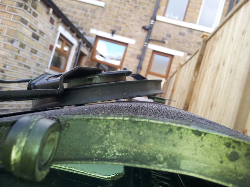

Looked at why those marks might have been made. Brian suggested that something might have got caught between the fans and radiator. That is highly possible., however the fans are rigid and not broken. Also there are no marks on the fans or assembly to indicate something had been caught.
I placed the fan on the radiator to see how much clearance there is. Not much. The slightest pressure on the fan and it was touching the radiator. We are talking probably a couple of mm. I think I'll add some additional washers to get more clearance when reinstalling the fans.
(Now that I think about it, sometimes I could hear a noise like the fan motor was going. I'm wondering if it was the fan touching the radiator very slightly)

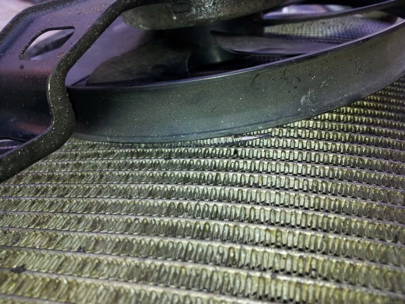

You can can see how much clearance there is here
Also, it's the fan housing that is making contact. Either that or something caught in it.

« Reply #17 on: March 18, 2012, 02:21:55 PM »
Yep, it looks like rubbing from the housing.  Has your bike ever been in an accident or had any work done around that area?
