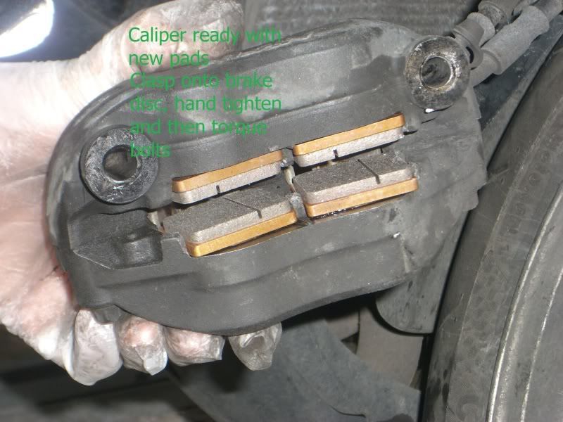

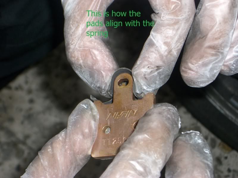

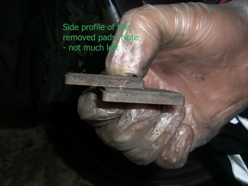

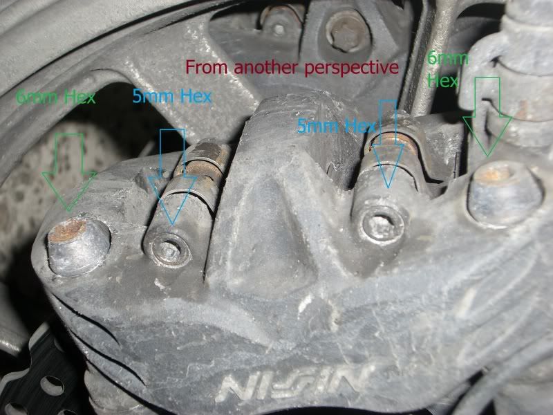

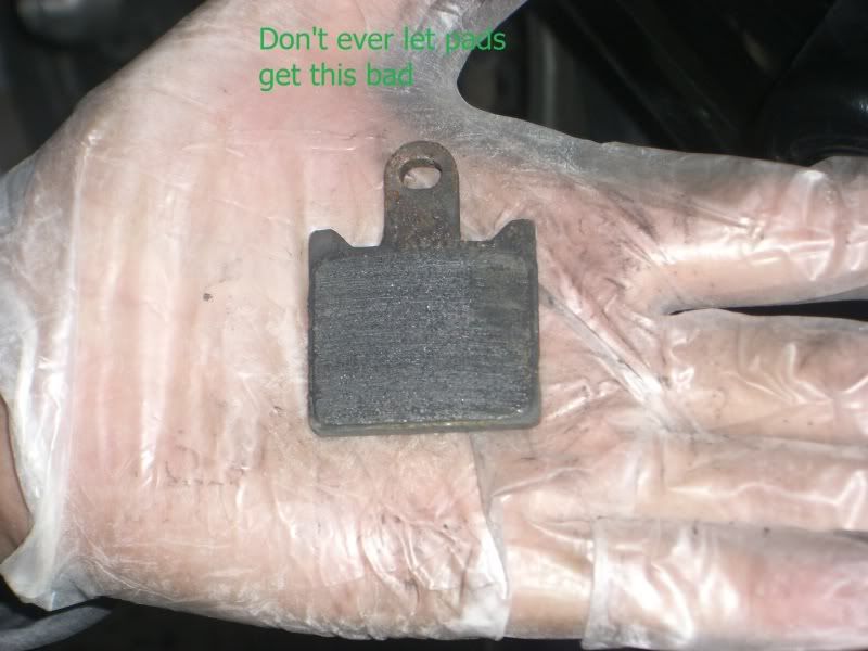

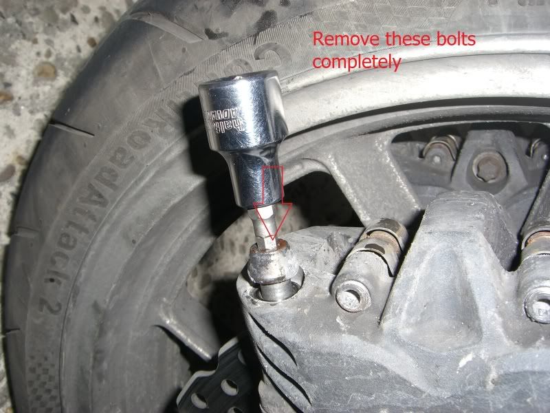

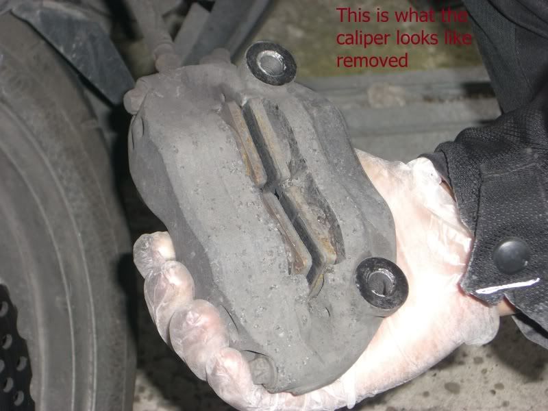

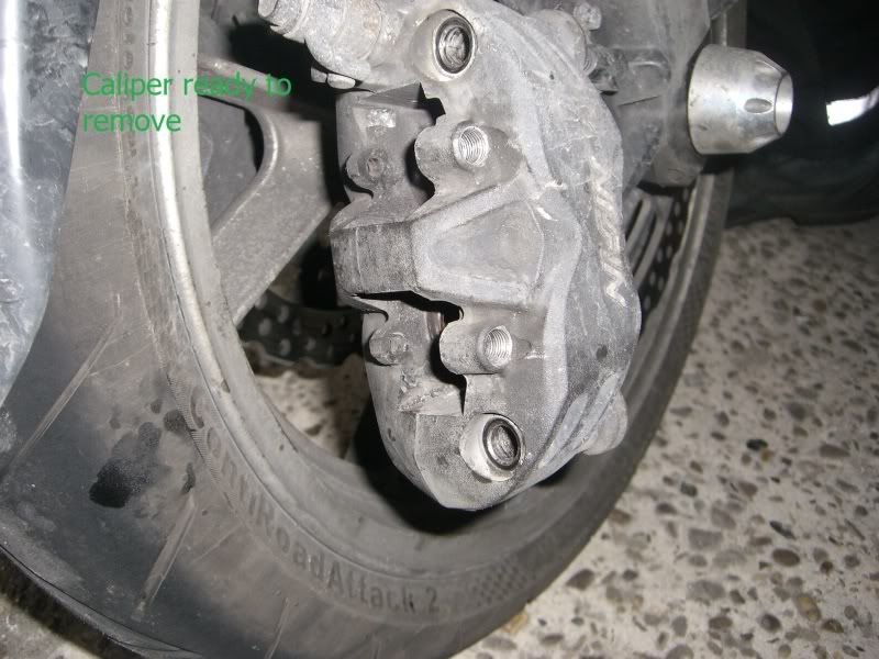

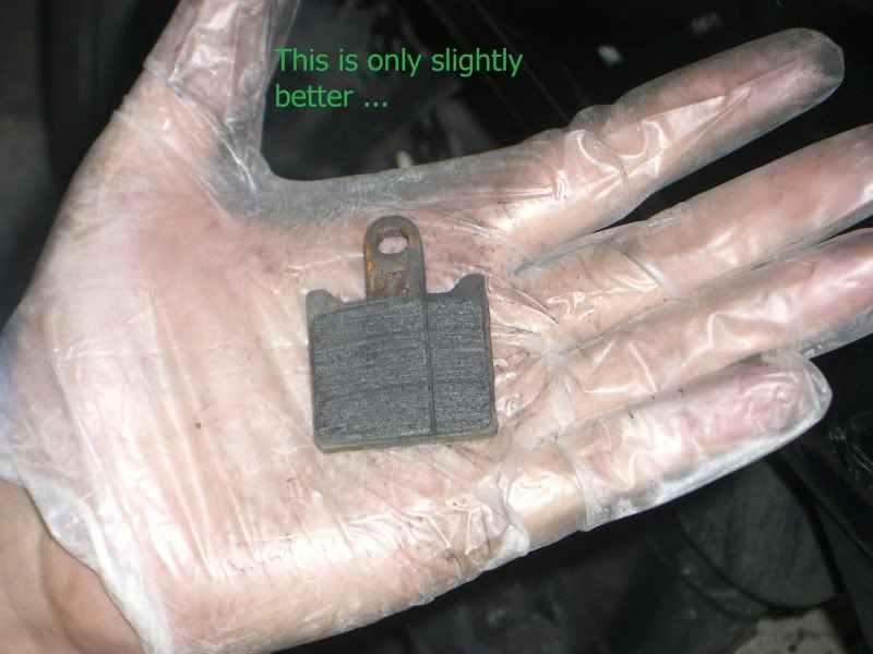

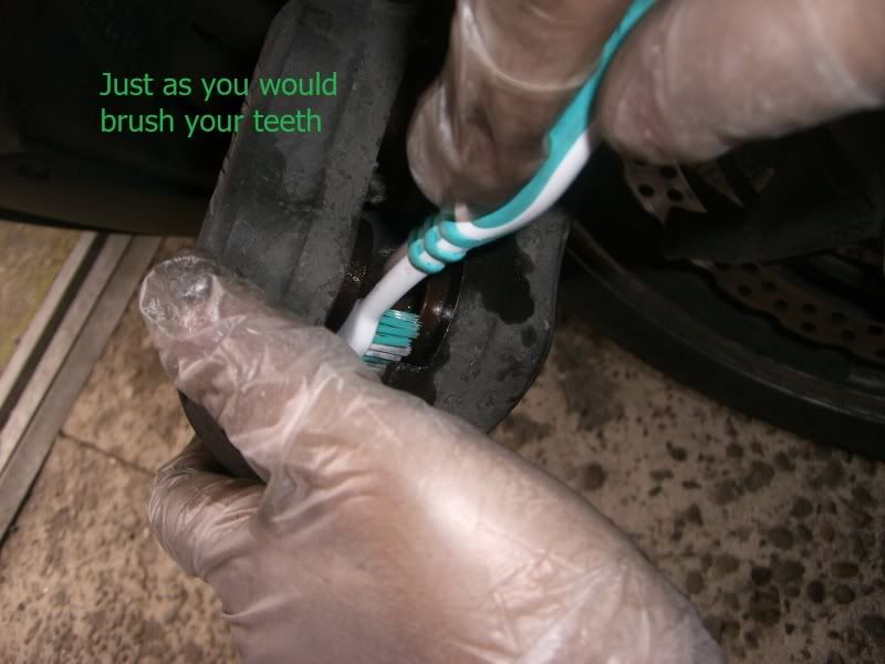

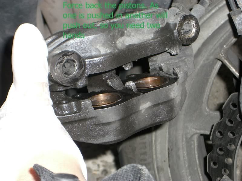

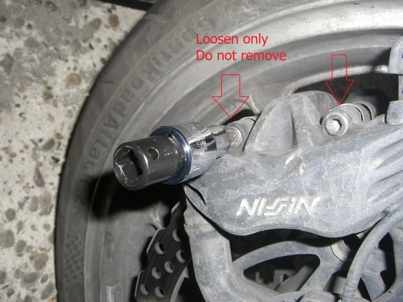

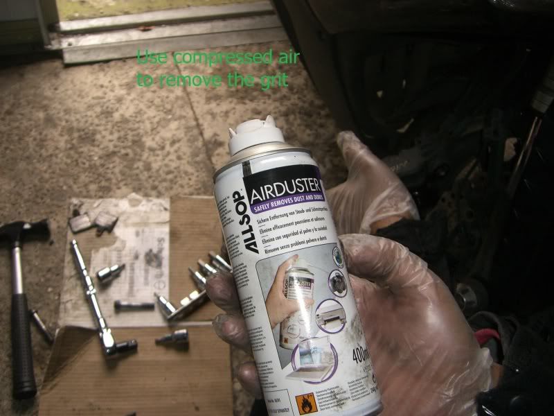

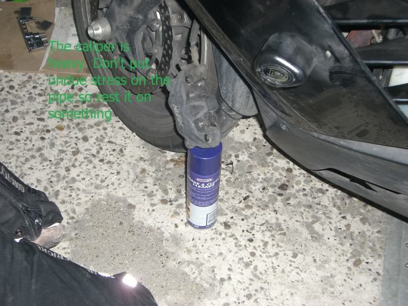

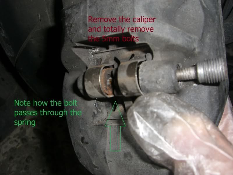

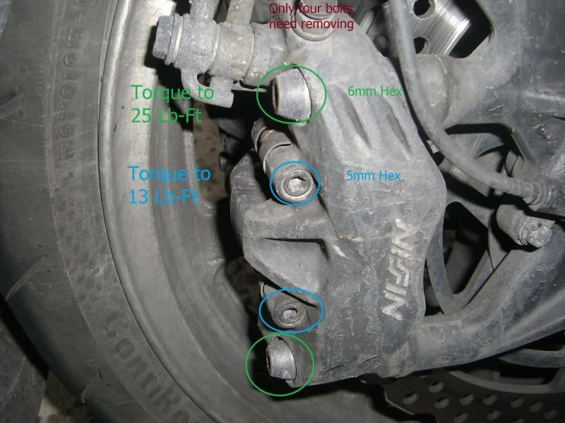

Finally had time to do some maintenance work on bike so decided to do brakes, and a good thing too as I'd have been trying to stop with metal scraping against metal.
Disclaimer: these are pics of what I did recently. If you want your pads changing, I suggest you hire the services of a qualified mechanic.

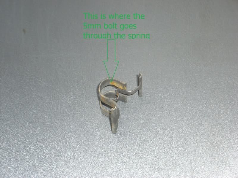

See first pic for fitting torque. Don't forget to grease the pads and spring. Now to do the other caliper!

If things aint quite as nasty all you need to do is remove the 2 5mm bolts and retainers, use the old pads to compress the pistons and install the new ones, takes less then 5 minutes and both sides are done.  I wore out my rotors (50000 miles), really shot, replaced them with EBC square drive buttons.  Absolutely love them.

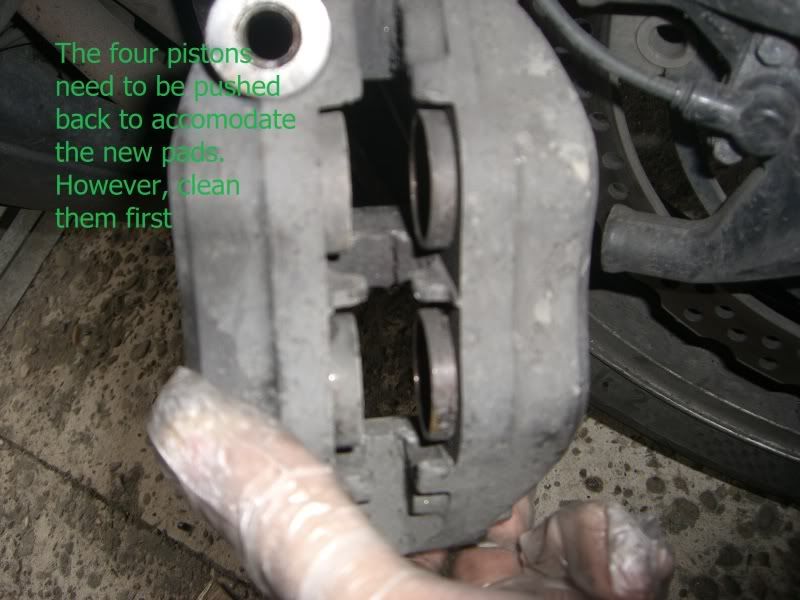

yes, you can do it that way, but the grit on the pistons is not removed.

I fully agree with you about cleaning the pistons thoroughly before pushing them back into the calipers. Driving the dirty piston back just forces grit underneath the seals. If the calipers had full bellows type boots then it would not be a problem but the seals are pretty exposed on motorcycles. I actually go one step further and remove the calipers and split them in half to clean them.

Be careful what you clean those pistons with. The reason is some cleaners attack rubber dust boots and rubber seals that seal the pistons inside the caliper.   And you do not want leaky calipers, do you?  I typically do not clean the pistons unless I remove them and rebuild the caliper(s).  If I clean them, i will just wipe them with a paper towel moistened with some WD 40 without soaking them.
Re: Replacing front brake pads
« Reply #15 on: February 06, 2012, 09:26:25 PM »
Non chlorinated brake cleaner is your friend.....
