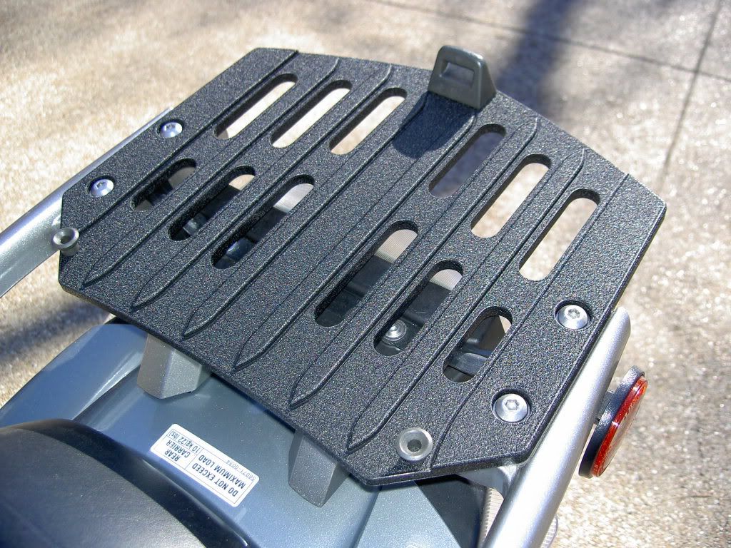

To be clear, as I already have Phils rack, adding the Kawasaki OEM top box;
1. Requires the use of the Kawasaki OEM mounting plate to attach with 4 screws/bolts to phils rack.
2. Outside it not looking as clean as a Givi (that does not require the plastic mounting plate) the Kaw OEM top box and OEM mounting plate attached with 4 screws to Phils rack is strong and should be reliable.

If you have, or plan to buy the Kawasaki trunk, or another brand that requires a mounting plate, I have sets of T-nuts made specifically for attaching these to my rack. They attach through the slots in the rack from the top and allow adjustment forward/backward about 3". It's very difficult to get a wrench under the front of the rack and these T-nuts can be installed with an Allen wrench from above the rack with no need for a wrench underneath. They also make a neater installation than the universal hadrware that comes with some plates. (Shown below on the right vs. the supplied hardware)
