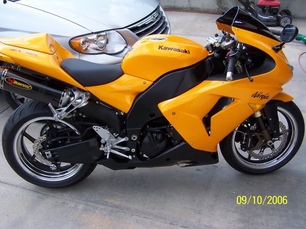

A while back I used the method of paint stripper and wet/dry sand paper on my wheels. they turned out great (I think) I did the outside edges and left the center black
it did take some time and lots of elbow grease

DonB, that's just what I am thinkng of.  Polished rim with the matte grey center of the stock wheel (which the rotors pretty well hide anyway).  I assume that you had to take the wheels off of the bike and about how much time went into the project?  What kind of stripper?  Great looking Ninja by the way.

« Reply #11 on: September 14, 2011, 01:27:23 PM »
I did not take the wheels off. easier to work on them while on the bike
I did both wheels one day but it took almost all day
I used a high grade aircraft paint stripper
be sure and use good tape to tape off the area you do not want the stripper. that way you get a nice line
use good gloves cause the stripper will burn your hands
I put the stripper on very heavy let it set till bubbles
then I used steel wool and stripper to get the hard area
then used wet dry sand paper.
when you get done they almost look like chrome.
it was a lot of work but sure did look nice when it was finsihed
