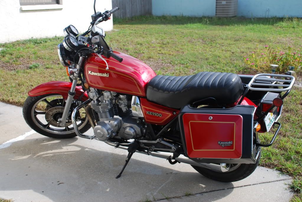

I've had some success in painting older bikes, on this Seca I painted everything except the tank and front fender. Color matching was done by the layers, or amount of the metallic candy red applied over a gold base coat. The more coats, the darker the color. Took some practice and do-overs. I shot this with a gun but used a rattle-can clear-coat, which I found to be more controllable and forgiving than the gun clear.
The bikini fairing was particularly daunting, since the size was larger than any other single part sprayed, and I had to apply the decals after the final base coat was wet sanded but before clearing, actually to all the parts. The clear went over the decals. The decals were designed for this.
In the KZ project, all I painted was the Vetter staddlebag covers and one side cover. I found a current Toyota Metallic Red color that matched perfectly so I did all that rattle can, DupliColor. The gold pin striping was also auto-parts store grade but likewise, matched perfectly. I clear coated (rattle can also) over the striping. Very light sanding of the clear before buffing. They came out pretty decent. I actually didn't want it too "perfect" since I wasn't painting the majority of the bike, I wanted simply to "match" the existing patina, so to speak.

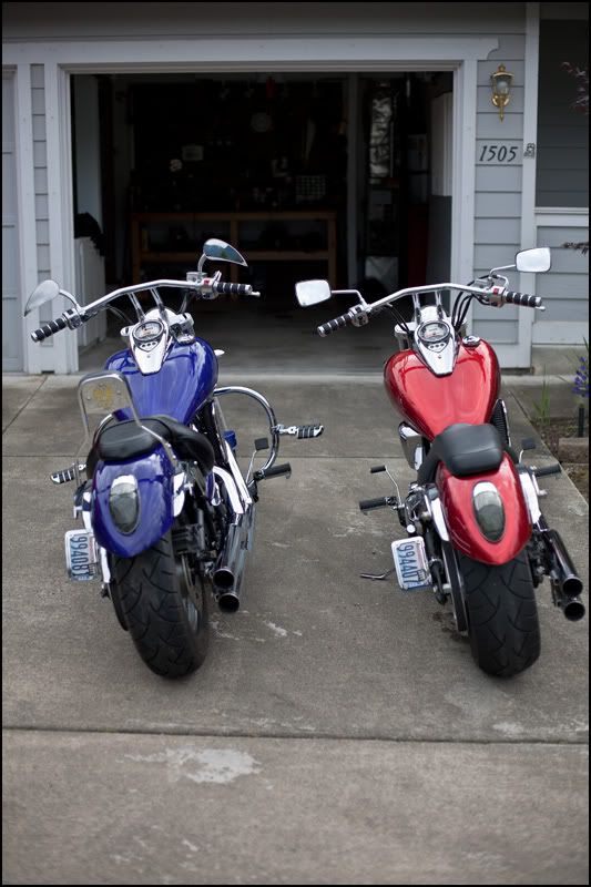

Here is another tip on those of you doing some sort of design and why you'll love base/clear:
My old vulcan 900 shortly before I sold it
I did the ghost flames in the same candy green as the rest of the bike (gets darker the more that is applied).  So obviously with another extra two coats of color there is going to be a little bit of a bump in the paint even after you clear it.  The nice thing on base/clear is you can sand it back down with 800/1000 and sand a lot of the transition edge out and then reclear it like I did on this bike.  It'll make the edge invisible and give you a show finish (that's what many guys will do when spraying a show car)  So if you're doing decals, stripes, color breaks mid-panel etc its a very nice thing to do to make it look better than OEM.
Here is the bike before it was green after I shot it red alongside my dad's which I also sprayed.  Note both bikes had the tanks and fenders cut and recleared and from back here you can't even make the flames out on the red and the blue you can only see see the reflection of them but no outline.
Alright, well I'm done rambling for now.  If anyone wants some honest help from someone who sells paint to DIY folks as well as sprayed a lot of motorcycles (or even the same one many times  ;D) feel free to post questions and/or shoot me a PM, not trying to thread jack lol.
