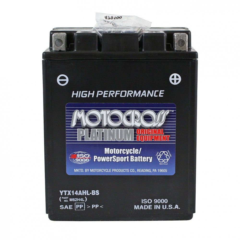

well, now we have numerous "weird" things....
stock battery "SIZE/RATING" conforms to a commonly available YTX14-BS "package/rating"
not YTX4, L, BS, or anything... that can't be the battery... simply too small...
BM Part #:   YTX4L-BS
Voltage:   12 Volt
Capacity:   3 Ah
Type:   AGM
Length:   4.5"
Width:   2.81"
Height:   3.38"
Cold Cranking Amps:   50 CCA
Shipping Weight:   5.00Lbs
size comparison, and polarity
YTX14BS
YTX14 L BS
size reference
BM Part #:   YTX14AH-BS
Voltage:   12 Volt
Capacity:   12 ah
Type:   AGM
Length:   5.24"
Width:   3.50"
Height:   6.54"
Cold Cranking Amps:   180 CCA
Shipping Weight:   10.40Lbs
as I said before, the battery attaches to the main relay....4 inches behind it... via an 8 to 10 inch long cable...with the bike "turned off" that is the extent of where current, from the battery, thru the cables, can travel to. Period.

stock battery is a YTX14-BS
AHHHH...no.
You are most likely correct about what would work, but it isn't the OEM "stock" battery. That would be the FTZ14-BS made by Furukawa. Allegedly a 14 AH battery.
I thought we covered this elsewhere, has Furukawa quit supplying the batteries to mama Kaw without telling me? (how dare they!)

AHHHH...no.
thanks, I corrected my description to "fit" my train of thought... when I typed that...
either way, it had to do with size,
Conrad:
there HAVE been a number of people (owners) that have actually installed/replaced the battery reversed, and also the cables...  without immediate detrimental side effects..and of course, it wouldn't start, but when reversed to correct, all was "OK"... not saying the dealers did them all;
