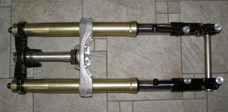

Got a tip from Lather (Thanks Bob!) about some ZX 1400 fork ass'ys available on Ebay. They are new 'take offs' meaning they were never ridden but taken off of brand new ZX 14s, almost certainly purchased for the engines in them and the rest parted out. Anyway, supposedly brand new, and they certainly do look brand new, complete forks and triple trees for $400 delivered- not bad at all.
The only defect I can see is that the hole where KiPass goes in not nearly big enough but I will not use the top triple clamp anyway:
As my bike is approaching 100K miles and I am sure could use some suspension maintenance / repair, this is a great deal I think. I will just replace the forks outright. ZX and Concours  forks are the same except for the fact that ZX forks have compression damping adjustment, they are gold anodized and they have lighter springs in them. I will probably have to put stiffer (easy boys!) springs in these forks but I am going to try them out just as they are first. The worst thing that can happen is that they will be mushy; I will of course be careful to check to see how far they are compressing without bottoming them out.

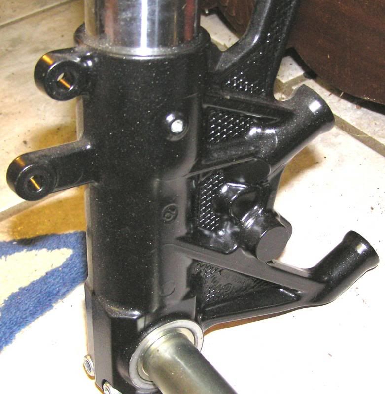

Can you post a photo of the black casting on the lower right fork (where the wheel mounts) please.  :D
That's where the holes would be if they are there.

Happy to- is that what you want?
There is a blind boss (not drilled or tapped) facing the wheel on the right / lower fork. Is that where the ABS sensor mounts?
If this is not the view / angle / side you want, just say so and I will do what is needed to get you that information.

That's good enough Brian.
Like Rembrant stated, the boss is there in the casting, but it hasn't been drilled out to accept the sensor or the retaining screw.
So anyone with a C14 that has ABS brakes that buys these will need to have these holes added to these forks.

The other side (the outside) has the outline of the sensor cast in the fork. As Pope said, it needs the sensor hole drilled and two holes drilled and tapped to take the sensor. So to use these forks on a bike with ABS, the holes would have to be made- it could be done with a hand drill being careful. The actual depth of mounting (easy boys!) of the sensor, which is the critical part, is controlled by the aluminum casting thickness so that is built in. The holes could be a little bit 'off' and everything would still work so hand drilling is viable but it would take some skill and care.
