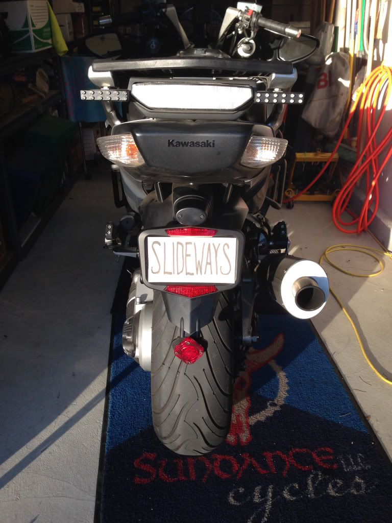

So really how sexy can a license plate frame get? But I believed in the Vololight concept enough to back their Kickstarter project. It arrived yesterday and was a 15min install.

Have you had anybody behind to tell you if it works?

Yes my ever patient wife was voluteered to follow me and give me feedback. First, they at least functioned as promised and second she reported that they showed up well.

How was the installation?

Mine came in to. Where did you hook up the power?

Did not use their connectors, cut and spliced into existing plate light power so they both work. Also drilled two holes about a half inch below existing holes in plastic fender and moved the mounting bracket down that half inch. This keeps the Volo from touching the factory plate light.
