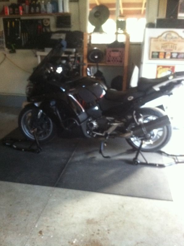

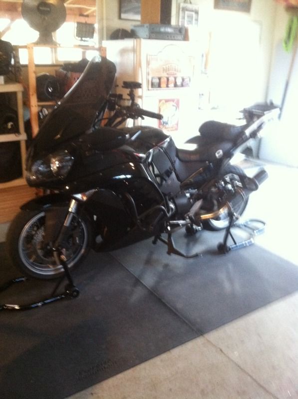

Mounted mine high and wide because they will be turn signals and I felt the 'Alert' feature would work better if they were higher. In the close-up the mirror is folded back. The alert flash helps when splitting lanes if anyone is actually looking. I did a custon install on the rear lights with a disconnect plug to allow for bag removal. Lately I have been commuting without the bags and just ordered a second set of rears which will get a custom install. Below is the install procedure.
The install was as follows to the best of my recollection. Made some cardboard cut-outs the size of the Skene lights and experimented with placement by sticking them on the mirror bases. The mirrors were removed from the bases, three bolts on the underside each, I think. The base itself is hollow and open to the inside of the bike. Measured and marked for the two small holes that would be necessary per side. Some masking tape over the area to be drilled allows for marking with a pen and seeing better the marks then working on the black surface of the base. One hole is for the small mounting stud the other is for the wire to the light. Used a thin strip of quality mounting tape on the under side if the light. Fed the wire in and through to the interior, and stuck the light in place. The mounting tape held the light in place and both hands were free. The PITA part was not the hook-up of the wiring but screwing the bolt with washer onto the stud within the tight space inside the mirror base. Don't recall exactly how I did it but have to assume it involved cussing, beer and holding my tongue just right (good luck). I may have actually lightly (lightly is very important here) super glued the nut to the tip of my index finger, installed the washer and spun the whole little assembly to get the nut started. If I did this then of course the wire would have been installed second. Probably used a little low strength Locktite and tightened the nut just a little, after all the lights only weigh a few grams. The hook-up of the wiring is well explained in the manufacture's instructions so I will not cover that.
Hope this helps.
