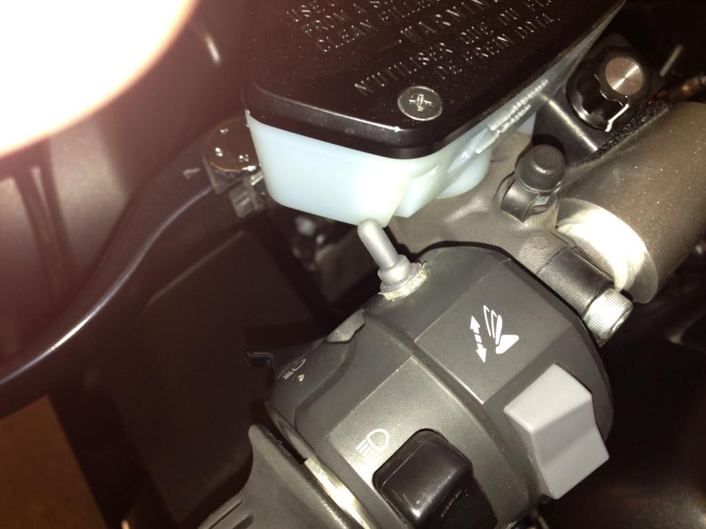

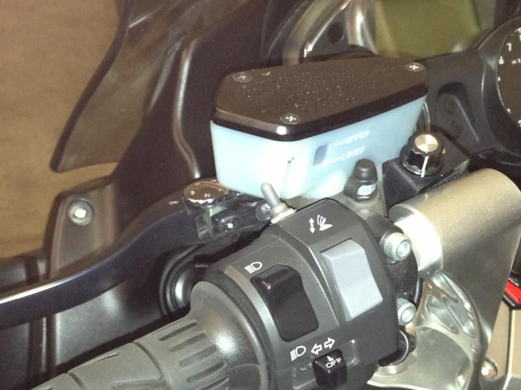

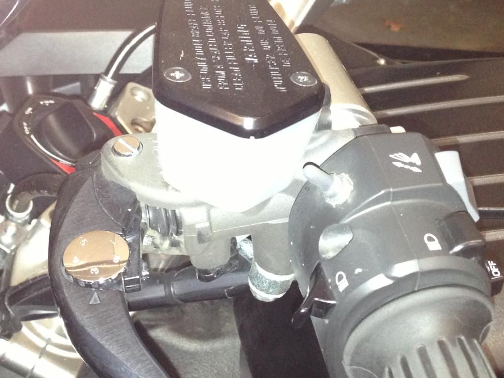

Believe it or not, I have had that same idea! What a coincidence.
Just so you can jump ahead though, you cannot get to the circuit that is the basis for the KiPass activation switch because it is buried in the ignition housing. That said, there may be another work- around for this problem.
http://www.zggtr.org/index.php?topic=6976.msg82841#msg82841

It is an old, well known problem and I have had a C-14 since 7/2007. Kawasaki has improved but apparently not eliminated the problem. Now of course the percentage of people who do suffer the problem has always been small but really it should be -0- in my opinion. After the first few people got stuck, I decided to see if I could introduce a work- around for the problem which I did way back. Unfortunately it required cutting into the factory harness which some people cannot or will not do. So I sourced the parts and cobbled together the bypass in the link I already posted. So far they have saved three (3) people from certain death! OK, maybe not certain death but either being stuck or having to do a lot of twiddling / hammering on the bike in the hope (without certainty) of getting it started. I am a long distance, timed event rider myself and to be honest, I just could not tolerate the idea that I might have to futz around with the bike at a fuel stop or similar and possibly lose an event over such stupidity as the failure of a switch worth about $0.03 (when you see one, you will be surprised that they ever work).
