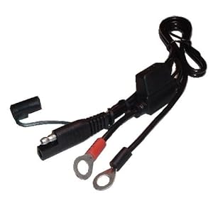

KEEP IT.  Just buy the +/- sae cable used with battery tenders and bolt it to your battery post. Takes all of 5 min and will save you in the middle of the sticks.
http://ecx.images-amazon.com/images/I/41VwHgzEyjL._SL500_AA300_.jpg
Maybe this has been covered before, but when you run any cable out of the battery area like this, or a GPS wire, etc., be sure you run it out of the upper right side of that metal plate that covers the battery. There is a small area where wires can run freely. Anywhere else and the wire gets pinched when you tighten up the plate bolts. Don't ask me how I know this.
