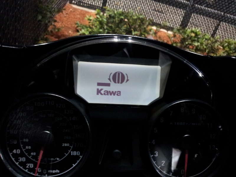

« on: October 23, 2012, 04:45:15 PM »
Today in my daily ride to work when first start it at 5:30 AM saw that there was some thing wrong with the display, turn it off and start it again and stay like that all the way to my work 22 miles away,  take those photos before turn it off, and when returning home at 3:00 in the afternoon every thing went back to normal , it is a 2009  with 25500 miles and i live in south Florida

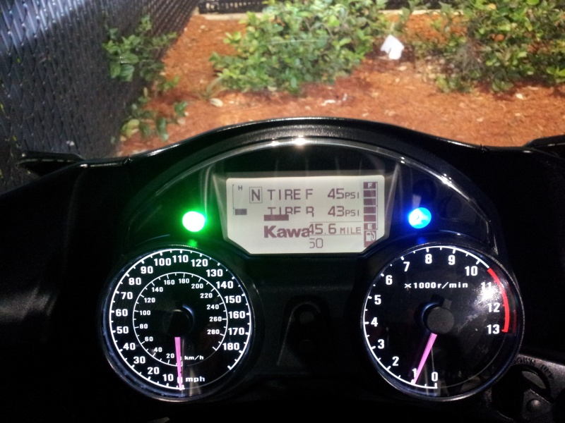

This  other picture is for comparision

That has happened to me on two occasions with my 08, which has 88,000 miles.  I believe in both cases the error did not resolve until the fob was taken out of range. In other words, turning the ignition on and off with the fob in range had no effect but when I turned the ignition off and then walked out of range with the fob in pocket the problem was gone when I returned to the bike and started.  So I believe it as to do with a communication error between the fob and KIPASS. And I am pretty sure in both cases that I was sloppy in turning the stove knob. I did not initially turn the knob all they way to the On position, such that it was temporarily in the between position.
I am not making any claims but after the second time I have been careful to be more precise in turning the knob and the problem has not returned. Also both times this occurred I was riding for extended periods in rainy weather.

Thanks for replay,some thing that happened after start the trip was the error message that say NO TRANSPONDER,  and stayed on for about two blocks, temperature was a little lower than normal this morning

Sorry bout your problem, but please drop those tire pressures way down....... thats got to be a hard ride.

I had this problem, the issue for me was the battery connections were loose.  The LCD was not getting enough voltage.

My vote is for the battery connection and not the fob/com issue.
You wouldn't want to see MY tpms display then, because it reads higher than that when the tires heat up!
(says one that prefers higher pressures.)

To me it looks likew some kind of dispaly driver problem. The display is working, just not refreshing properly. May be a loose or bad solder connection on the display board in the head unit.
i agree with you,that's why i state about the difference on temperature compared with the days before
