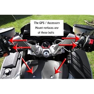

Now i get it! I find this image on Amazon, showing all the places you can fit a ram ball on the C14
So i will cancel the useless ugly 017BRU-0025 plate and order the proper ram ball ram arm and ram back plate system. I will mount it on my right handle so it will be in my line of view. So thanks for putting me on the right balls!
