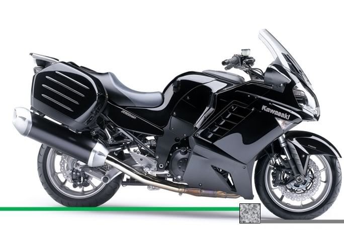

I went to take money from the ATM yesterday and when I drove off I had to go down a curb. This f---ing thing was higher than I saw and the bike ended in this position:
The result is that now one of the pipes coming out of the exhaust (whatever that's called in English... manifold, perhaps?) down there has a curb-shaped bump, and a noise suddenly started. It sounds like an exhaust valve badly adjusted. Three things come to mind:
- the manifold (part number 39178) ist one of the most expensive part of the whole damn bike  >:( and I hate coffing that kind of money for such an uneventful thing. I wasn't doing 200 mph on the wrong lane, for f--- sake!
- every single part of the bike seems to be available for buying in Germany from crashed bikes, not this one.
- why do I now have this noise now? could one of the shims come out of place from such a hit? or is it something else? with my limited knowledge, it does sound like a valve. It is stormy here in Munich since yesterday evening, but if the weather gives me a break I'll drop by the dealer today after work.
I am properly, epically pissed.
