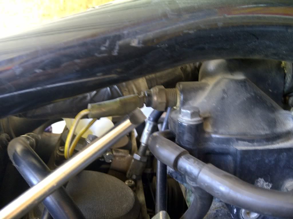

T Cro, is this the sensor that you are referring to? If so, it does wiggle a little bit. Definitely not enough to lose contact, but it wiggles nontheless. I wonder if tapping it with a punch and hammer would do it. If not, would soldering be an option?

« Reply #9 on: March 22, 2012, 06:38:11 PM »
To answer your three questions:  Yes, yes, and yes.
Although be careful with the soldering, as too much heat for too long will likely damage the sensor.

« Reply #10 on: March 25, 2012, 08:46:53 PM »
Just wanted to report back.
I was able to punch the connector back in place with 2-3 "solid" taps with a hammer. I used a 3/32" punch to do so. When that was done, the connector felt solid with absolutely no play to it. I hooked up the gas tank after that and gave it a try. With the bike parked in the garage, the temp gauge reacted smoothly as it should. The fan kicked on when the gauge was 3/4 of the way to the right.
Yesterday I took her out on the open highway for 40 miles of 70 mph and the gauge stayed just above the white block and moved smoothly. While stopping at a light, it smoothly increased in temp like normal.
Thank you all for your input as it fixed this issue. Great knowledge on this forum!
