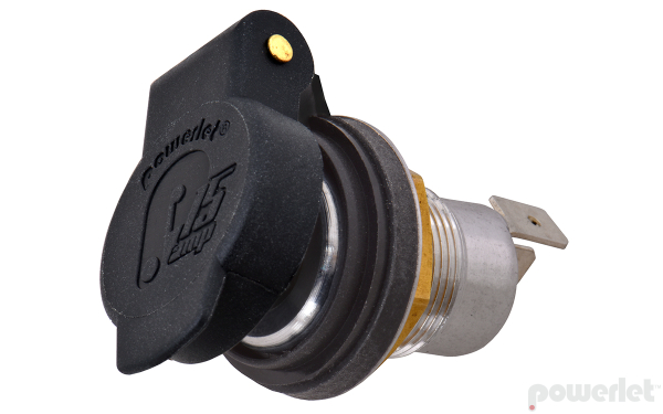

the reason I've asked is that I want to add another cigarette/Powerlet outlet to the left hand side of the dash where there is a circular 'Blanking Plate" just next to the headlamp adjuster.
Needed to take the screen off to neatly get to the pop in/out plastic rivet that holds the infill moulding on.
Then I can hook up the cig/Powerlet outlet up to the male/female bullet connectors under that hood thing.
I'd rather not drill holes in panels and that knock out blanking plate hooked up to the fused 10 amp (on the 2008's) looks the biz.
(Thanks to Fred Harmon for the pics, clickity click
It's hard to find just the cig/powerlet socket on Powerlets web site, you have to put "PSO-001" or "Standard Powerlet Socket"
Powerlet have been asked if they can provide a plain socket with a weather resistant rubber boot and a set of short leads terminating in bullet connectors to suit the fused ones under the left panel.
Tell you what they say when they reply.
