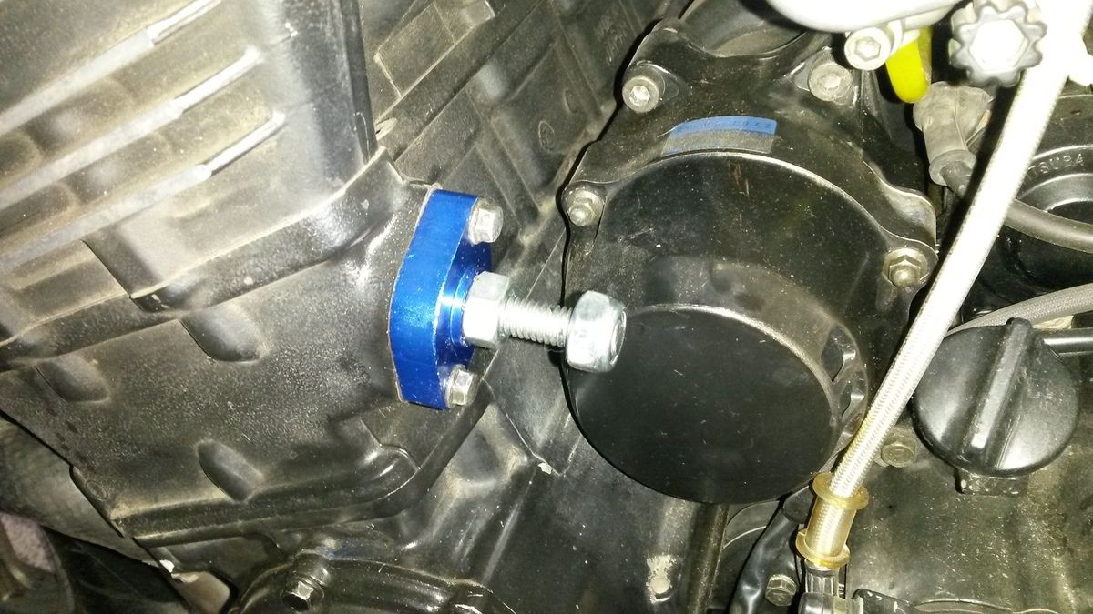

Could this be it? What is it btw and how do I fix it

Yup, the camchain tensioner has blown it's bolt out. Plenty of oil comes out of there.
Replace the tensioner with a cheap manual tensioner from Amazon or Ebay for about $50.

There is still thread in there and it looks like it might be a helicoil.
Get someone you can trust to check it out.

Do you know how to set the tension on the manual unit? Too tight and you can burn up the chain guides. Don't forget that you'll also need the gasket, 11009-1858.

Me, I do with a mechanic’s stethoscope, I start to tender by screwing by hand without forcing then, I refine not to hear any clicking, at 2000 rpm.  ;)
