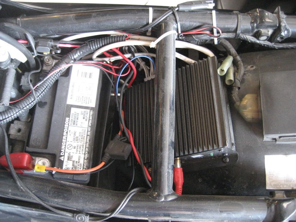

Here's the amp under my seat:

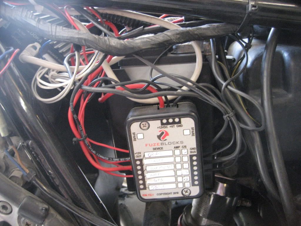

Here's were all the electricity comes from, a FZ-1 Fuzeblock

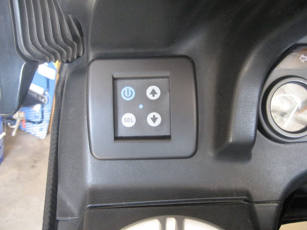

Left speaker with remote:
Remote:
Full view:

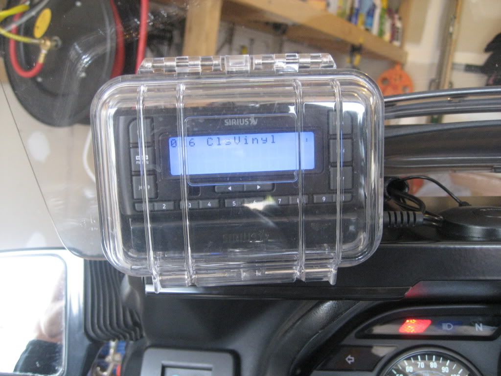

Sirius mounted in Pelican case, cover flipped open for access to buttons:
Cover shut, water resistant, still fully visible (I call it resistant and not waterproof because I did have to drill a hole in the side of the box for the wiring.   The hole is in a place where it's no factor unless you were to completely submerge it):

Overall the stereo is awesome.  The remote is a bit of a stretch to reach, but I couldn't figure out any other better solution.  The one thing to note, there's no mute button, just the power button.   You can shut it off quickly by simply turning the amp off, but when you turn it back on, the volume will be all the way down.   That also happens when you turn the bike off.   When you fire it up the next time, the volume will be down quite low.  I actually like this "feature" because if I roll in the garage rockin' out to something, the next time I turn the key it won't blast me outta house and home.   But if I want to shut it off quickly while on the road, you have to hold down the volume button to get it going again once you turn it back on.   I hope that makes sense.
