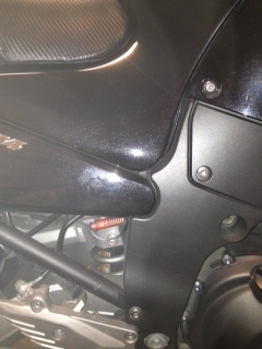

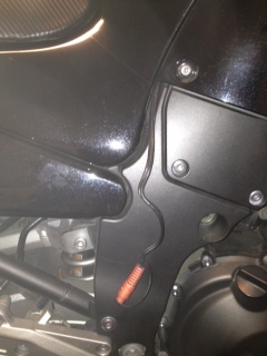

Just run the battery tender pigtail from the battery to some easily accessible point outside the body work. Here's what I did:
Tucks up nicely out of the way when not in use.
To clarify; this is my heated gear lead, too. I added a little 6" SAE-to-coax adapter to my battery tender and use the same connection point.
