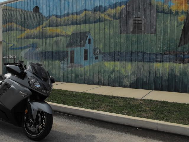

Well horse-hocky.  I was going to paste a link to my thread that showed all of my farkles, including the horn.  But I forgot about the damn forum crash  :(
I mounted mine almost exactly as CigarSki posted above.  It's a pain in the ass to do, but that is the only place I could find.  Here is a picture that sort of shows it....

That's a neat install but what did you do with the charcoal canister?
