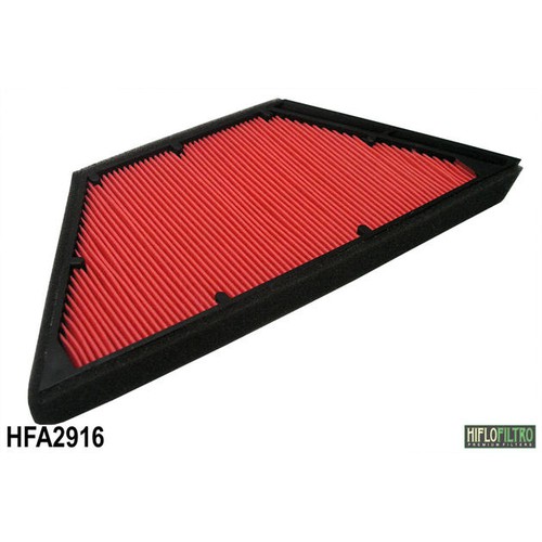

gonna go out on the limb again, and suggest pulling that air filter out, for inspection and replacement if needed...
Search online for the HiFlo brand, it will save big $$ and works as good as OEM
