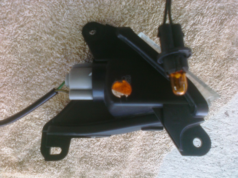

« Reply #20 on: August 29, 2013, 08:02:18 PM »
I did it this way
2009 Non ABS Concours Black
2006 Honda VTX 1300 C candy Orange

Re: Front signals as running lights
« Reply #21 on: August 29, 2013, 10:54:48 PM »
I did it this way
Certainly works, but way, way too dim for me.
