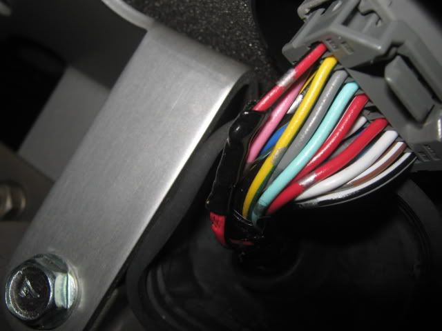

Too bad they didn't fix the high beam indicator (make it dimmer). WHen using the high beams, that things is like a blue laser, burning into my eye.
I detailed my fix for that excessively bright high beam indicator way back in 2009 on the original forum before they erased it and all the tech stuff that was posted. (Supposedly to prevent a big legal battle)
I'll look around for my original instructions on the fix.  There is a very specific value resistor you need to add to the back side of your dash panel. Pretty easy fix.

Sorry Jim,
  The text is gone and I have no notes on the size of the resistor.  The indicator is an LED and I 'believe' the resistor is something very low, like 56 Ohms installed inline with the
Red supply wire at position #1 of the indicator/Display connector as described on page 16-104 of the hard copy 2010 Service manual.
  I'll remove the heat-shrink tubing from my resistor if I'm ever back in that area. I had to try several different values to get the indicator dimmed but not off.  As it is, my indicator is visible in daylight but not blinding at night. Mine is on a lot since I have the headlamp modulators installed.
I will add a picture here:
Mick
