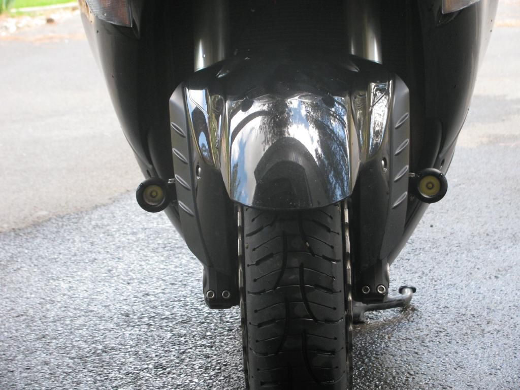

I bought spacers from Lowes and longer bolts for the fender bolts. (pardon the bugs)
I plan on doing this if I ever put lower fogs on.

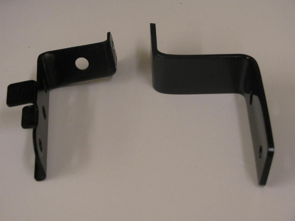

I read about the thin reflector metal breaking.  Bought some flat steel and simply bent them to match the reflector bracket.  It is very stout.
What about the right bracket, the bracket that holds the cable (has the "hooked" bend to hold the rubber grommet), how did you handle that?
The brake line runs right next to the front wheel speed sensor.  (cable with rubber grommet)  The wiring for the light runs right next to those other two.  I zipped tied them together.  The stiff brake line is not going to move and keeps the other 2 right where they need to be.
xsv, what gauge/thickness steel did you use?
1 inch wide by 1/8" thickness.  I bent them, sandblasted them and just spray painted them.  The next time I have something powder coated I will take them off and do it "right". :)
