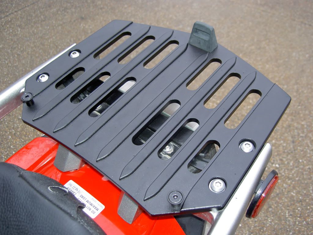

Offline philipintexas
  • Posts: 480
    • Phils Farkels
Re: Stock Trunk
« Reply #5 on: March 15, 2012, 10:09:01 AM »
The Kawasaki trunk comes with a universal mounting plate like the one pictured below. If you keep the stock rack you will have to use a mounting plate such as the Kawasaki trunk.  The Givi monoKEY trunks can be attached directly to an after-market rack with the optional ($20) mounting kit as shown in the second photo. The mounting plate offers some fore/aft adjustment, while the monokey is fixed in a single position.
