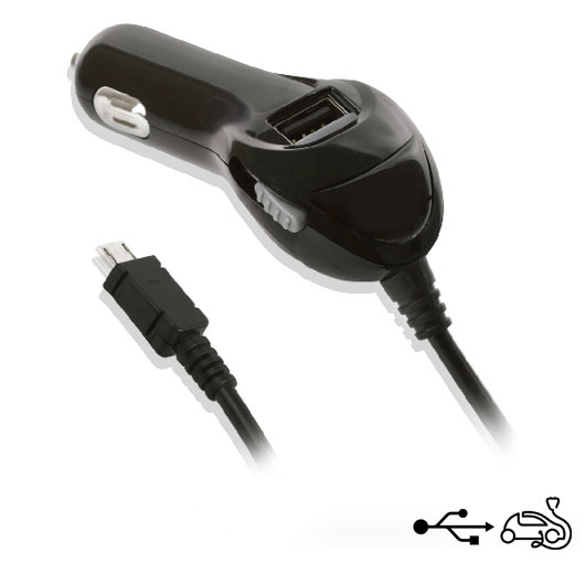

This works rather well too....
Available at most BestBuy stores.

Re: 12V to micro-usb (5V smart-phone) on the CHEAP
« Reply #12 on: August 24, 2011, 04:12:04 PM »
Thats like the one I use from Pilot truck stop. Mine has a pretty blue glow.  8)8) 8)
Have to remember to take it out when it rains though. I like his pigtail because I can put it in the box and everything stays dry and my droid keep on talking to me.
