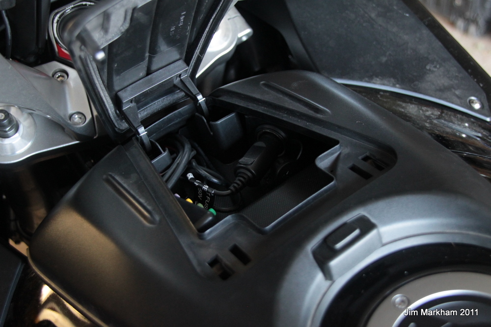

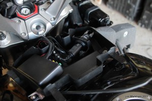

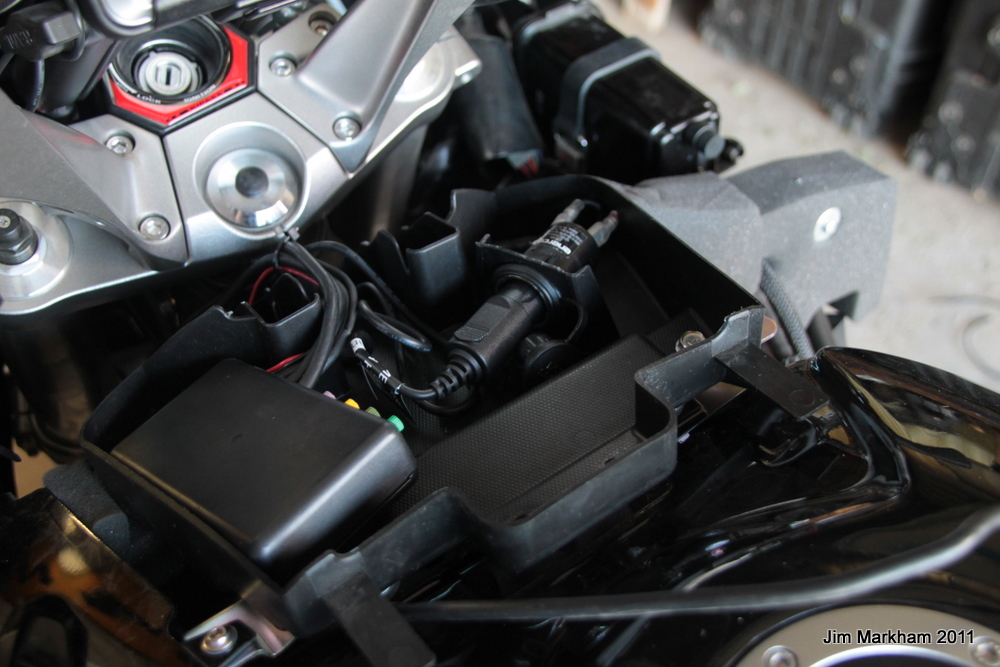

Fuzeblock under the seat.
Wire forward to extra cigarette lighter in the tank-top glovebox:
All buttoned back up:
Extra connector cost $6.99 at Radio Shack, and took some trimming, but fit in the glove box fine.  This frees up the in-dash connector to run a line to a cell-phone charging inside a tankbag, or to power the radar detector.
