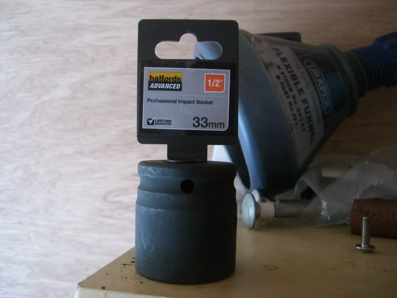

Found a socket that fits the outer brace nicely whilst not big enough to get stuck in the housing.

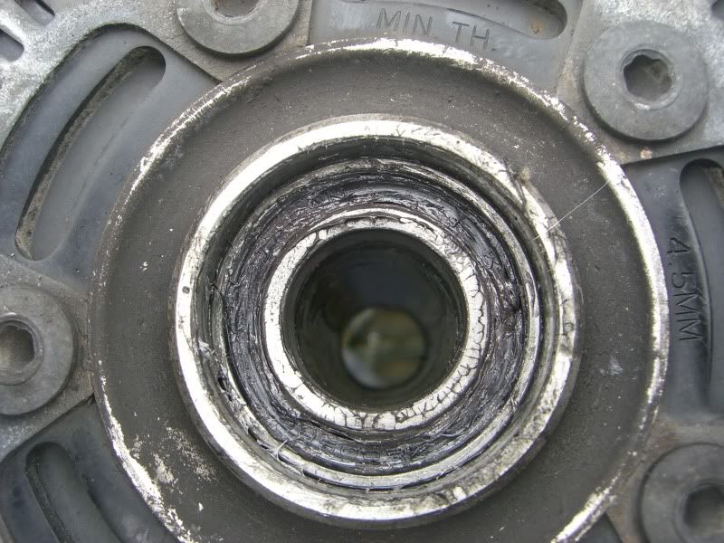

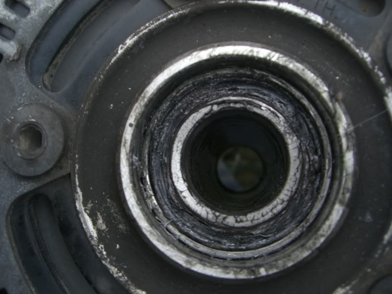

Put the bearings in today. I have a question: how flush should the spacer be between the bearings? When I originally took the bearings off, it wasn't flush at all. After I messed up bearing install no2, I realised I had it quite flush. I asked my dealer and he stated that it should be flush, but not overly so. So that's how its done on bearing no3. To move spacer out of the way now requires a little bit of force.
This might should like a stupid question after I've replaced the bearings, but what's the relationship between the wheel, bearing, and axle? I assume the bearing functions once under load in conjunction with the axle?
Some pics of the bearing and spacer. If the spacer is moved to the side, only a few mm of the inner brace will be visible. I used a flat blade screwdriver to knock them out as there was no chance of ever hitting the housing.

And the socket size to hammer the bearing in. Fits perfectly onto the outer brace and small enough not to get stuck in the housing
