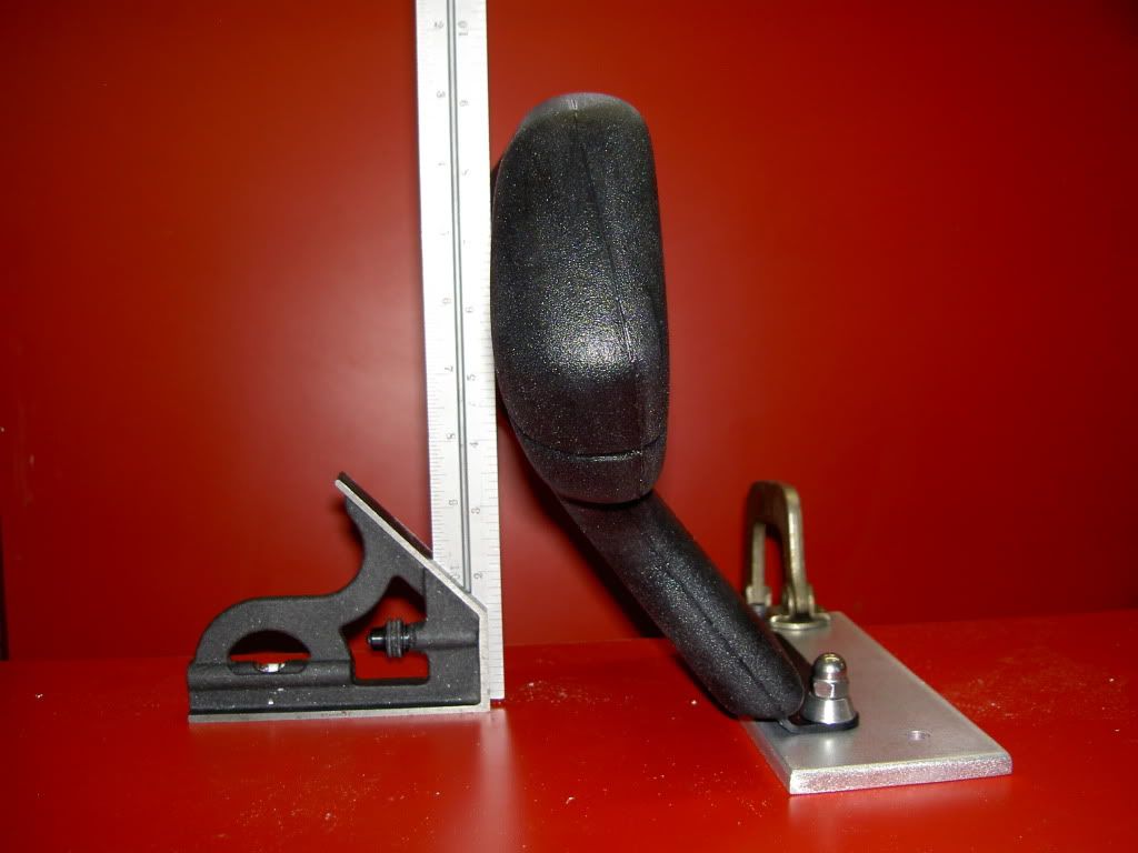

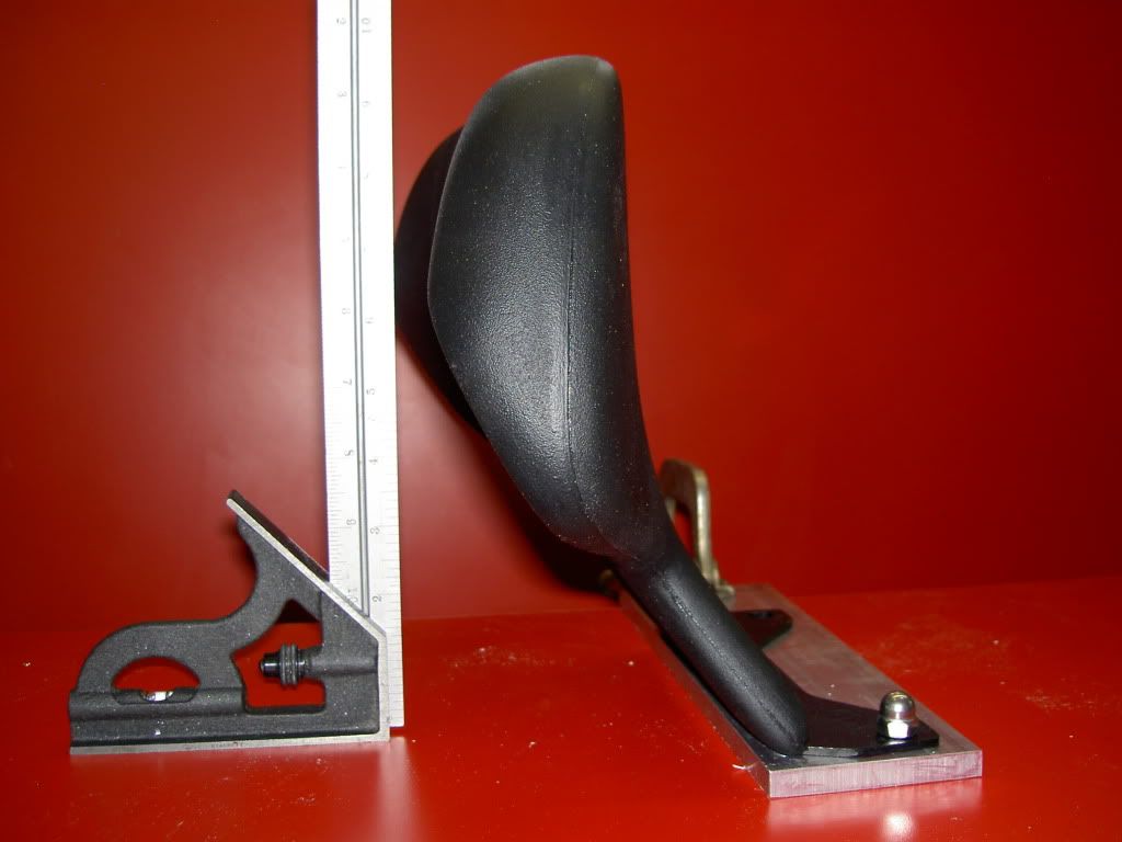

Your post is the first I've seen of the optional Shad metal mounting plate and it got me wondering if one could attach a scooter backrest, similar to the two pictured below, directly to the leading edge of the plate in a way that would'nt interfere with the trunk? Some people want both a trunk and backrest at the same time. Does it look like this could be done in a safe sturdy installation? I'm talking about attaching the mounting tabs of the backrest to the Shad metal plate without the plate shown in these photos.

An optional backrest is available for the top box which I initially fitted . See pic below. However when my wife tried it out , she found that it restricted her space and was not very comfortable so I removed it and she is now happy . These backrests are about 75 mm at the thickest part on the top pad and about 50 mm at the thickest part of the bottom pad. She is quite slim at 5' 4 and 135 lbs. If the backrest was essential, one could rotate the plate and redrill to fit the bike rack and box mounting plate which would move the whole system back.
On the question of fitting an additional backrest , here are some of the dimensions.
The plate is 3 mm thick and the flat part is about 160 mm wide.
The plate extends about 20 mm in front of the bike rack.
The box extends about 75 mm from the front of the bike rack and about 55 mm in front of the mounting plate.
The clearance between the mounting plate and the bike rack is about 13 mm. See pic.
The scooter backrest would need to be mounted between the plate and bike back rest in the 13 mm gap.
Holes could be drilled through slots in the box plastic plate and through the metal mounting plate . These would be about 14 mm  from the front of the metal mounting plate and about 140 mm apart . In the pic these slots are just below the top red fastener. The curve of the metal plate underneath can be seen.
