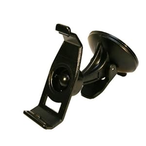

i would heed the advice of one of the poster's and tether it.  I've noticed my Garmin when stuck to the windshield of my car and park in the sun it has pop free.
I bought a extra suction mount from  Radio Shack the one with the arm the you can angle. I also bought a Tech Mount (from Murphy's) and remove the round plate. I just ran a bolt the center of the Garmin mount into the Tech Mount. It ain't going anywhere.  For added safety I also put a fishing line between the GPS and the provided Garmin adapter and tied that to the Tech Mount.  I would post pictures, but I recently added some risers and need to get some extra long bolts for the Tech Mount.

I wouldn't trust the suction cup.  Just not worth seeing it fly off driving down the freeway.

FWIW… On my C-10 I’ve used the OEM Garmin suction cup mount for my old StreetPilot c330 GPS with no issues. Had it on for 3 weeks and a 1500 + mile trip through 3 states.
I’m real careful about cleaning the windshield, wetting the black rubber disk first, and the applying pressure while moving the locking lever in place. When I mount it this way, you will only see a small dime sized section of ‘air’ in the suction cup.
